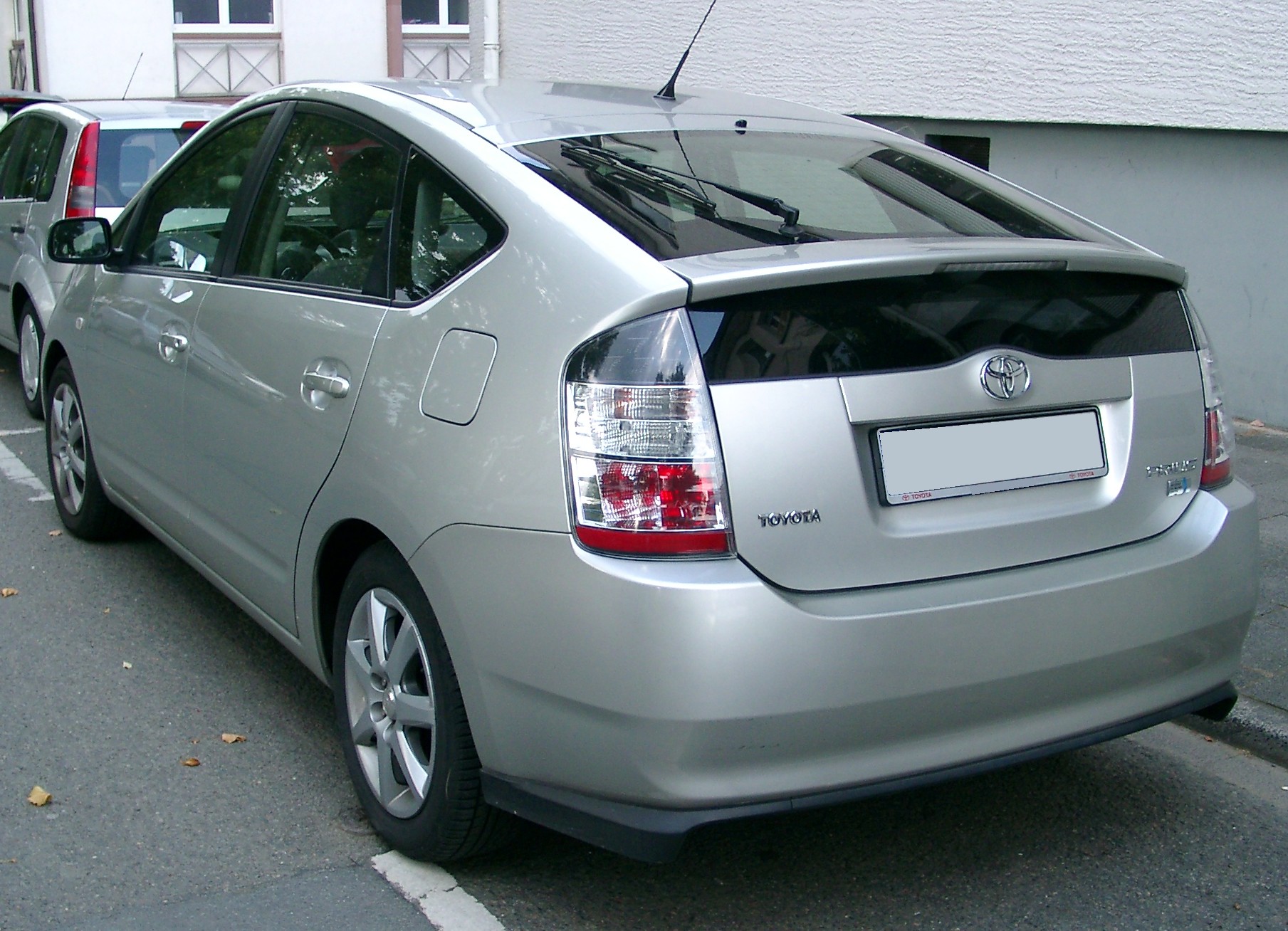

  10. Tideland Prius
    45,422
    16,668
    Possibly. The van was parked to one side. The radar may or may not pick it up. It's an out-of-the-ordinary situation and one should always assume the vehicle won't respond as expected. It's an assist feature, meant to make life easier.
    Yeah there's a hard curve that I travel occasionally where the highway curves from westbound to northbound and the Gen 3's DRCC will lose lock and if you let it be, it will be a rocky ride around the corner as the car locks and unlocks and accelerates and brakes. Like you, I cancel DRCC for that corner and resume it after it straightens out. I think the Gen 4 will actually cancel DRCC in a corner such as that. (Based on the media demo)
    No. I have suggested that to Toyota before at one of our Prius Expert meetings. They have the equipment (e.g. on the Lexus LS or Toyota Crown with rear facing millimeter wave radar), they just need the software code.
    Besides, you should be paying attention anyway and you would take evasive manoeuvre. It won't slam on the brakes but it will brake hard if necessary. And really, at that point, it's PCS that's taking over not DRCC.
    Depends on the year. Older vehicles (I mean early 2000s to maybe a few years ago) had multi-LED setups for brake lights (both CHMSL and regular brake lights) like the Gen 2 & Gen 3 Prius. As technology improves, fewer physical bulbs are needed to produce the require lux to meet regulations. The Gen 4 now uses just one bright LED for the regular brakelights and one of those is much brighter than the 6 LEDs on the Gen 2. (6 per side). On the older ones, if one blows out, it's not too big of a deal since the rest will still illuminate (they're not wired in series) but of course the light as a whole will be dimmer as each bulb blows out.
    On the Gen 2, it's not smoked plastic. It's just black glossy painted plastic. (Smoked makes it sound like the cover is darkened, which isn't the case. It's a clear plastic housing). I think it was a styling design, meant to visually widen the lower rear glass. It also means each bulb appears larger because it's reflected on a curved surface, thus increasing the surface viewing area of the brakelights. The bulbs themselves are tiny and look like the 2006-2012 RAV4 taillights (which aren't reflected and are directly visible to someone looking at the RAV4).

  12. wrprice
    wrprice Active Member
    Jul 11, 2005
    415
    308
    Houston, TX
    Four Touring
    Doesn't line up with my recollection of my '05. It sure seemed like the cover was not clear for the topmost section. But I'll take your word for it, as it's been two years since I last had it. I'll take a closer look the next time I walk past an '04-05.
    Whether the darkened look was because of the surrounding plastic or a darkened/smoked cover would indeed make a difference in how much it interfered with brake light visibility.

  14. Tideland Prius
    45,422
    16,668
    I would take a photo but we traded in our Gen 2 six months ago. Here's the largest photo I could find on the internet.
    The cover itself is clear. The top part that is housing the LED brakelights is black plastic, giving that dark look. You can see the reflection of the trees and the sky on the taillight that give some indication that it is clear. In addition, if you look at the side of the cover, you can see that the taillight, reverse light and indicator backgrounds are chrome and the brakelights are black, again another indication that it is the background that is coloured black, rather than the cover that is smoked at the top section. Of course if you can see one in real life, then have a look for yourself :)
