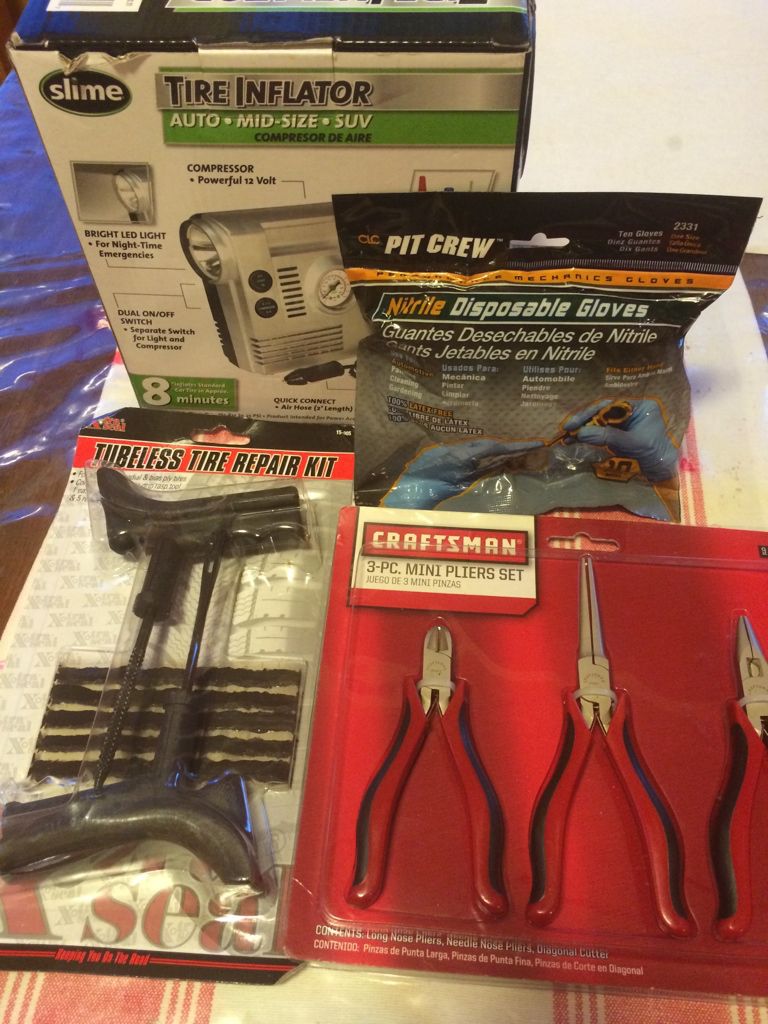

    This is the flat kit which I keep in my Prius:
    1) Tire Inflator: The inflator which comes with the car ONLY works if it's injecting goo.
    2) Tubeless Tire Plug Kit
    3) 3 Piece Plier set: Pliers for pulling the nail from the tire, and diagonal cutters for cutting the plug once it's installed.
    4) Gloves so you don't get filthy
    When you pull the nail/screw, pay attention to its angle, because you want the plug to go in at the same angle. You don't want to punch in a new or enlarged hole.
    Robert Holt, EvanB, F8L and 3 others like this.

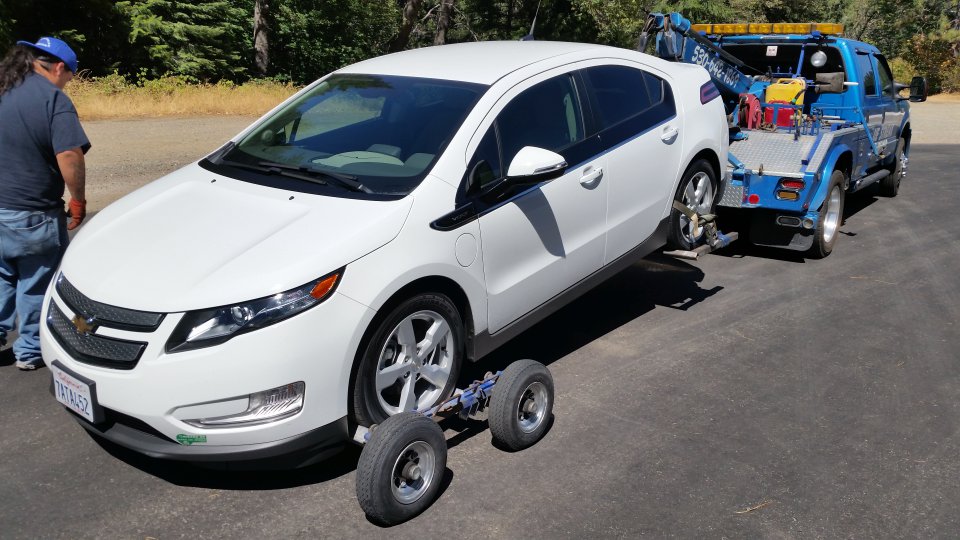

    Ran into the same problem in my Volt.
    Ran over a piece of beer bottle glass and slashed the shoulder of my tire. On a Sunday, over 100 miles from home in Tahoe. Tried using the foam that comes with the car kit but it just sprayed out. I tried a can of Slime and that only led me to believe I could limp it home. I made it about 20 miles before the tire was wasted. Called State Farm for a tow and $100 and 4 hours later I made it home...........
    With a spare I would have had the tire swapped and been on my merry way in 20min tops.
