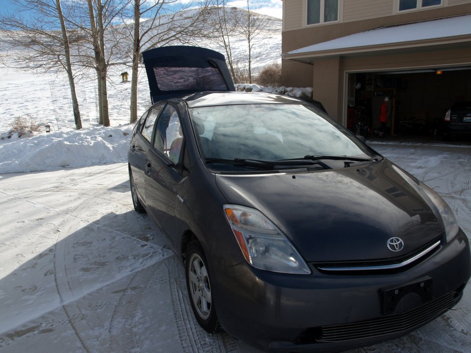

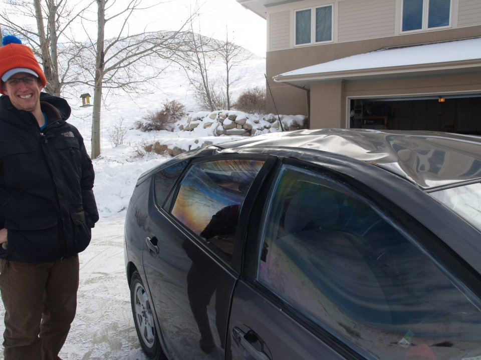

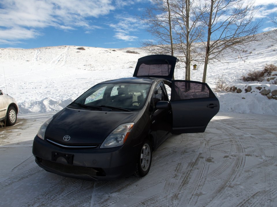

    This is the car! It drives fine and the heater works well at -15F in north-central Wyoming.

    Did he bump out the roof a little? Doesn't look too bad at all.

    He and a friend made a wide hook out of some scrap metal and pulled up the beam over the rear door a couple of inches using an engine hoist. He also pushed with his lefts from the back seat to raise the roof about 4" at the same location. What isn't shown is the 3/4" overlap between the top edges of the front and rear doors on the passenger side. He'll soon trim that much off of one of those doors because it is awkward to have to open the rear door before closing the front door.

    I'd be more concerned about wearing that hat in public ;)

    The car looks ok to me but, that top can be straightened out a whole lot more.
