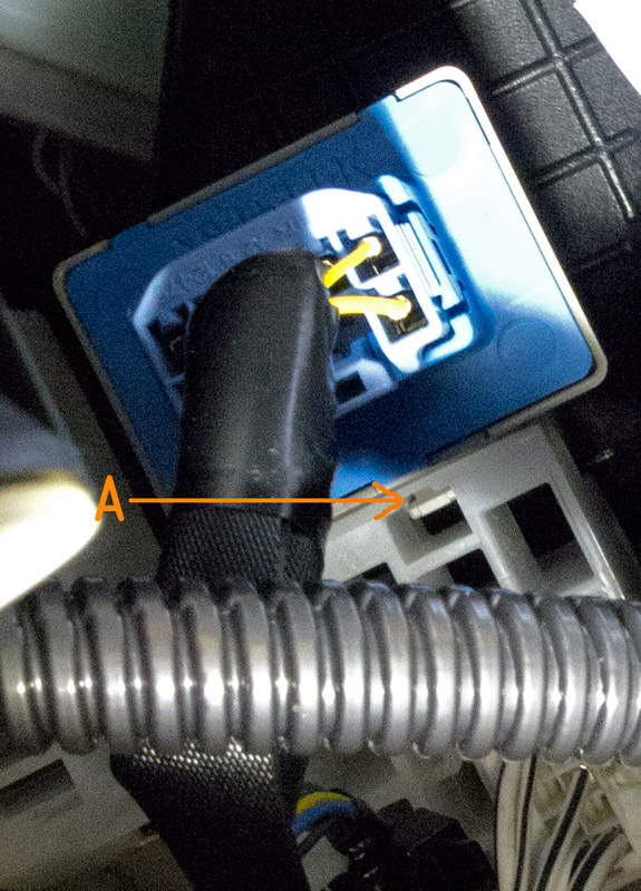

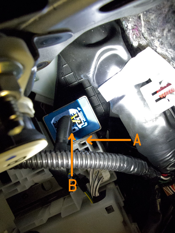

    I finally was able to replace the relay. It turned out that I was looking at the wrong connector in my first post (#23). Here is a pic I took to help me figure out where things were at:
    If you want to remove the original relay you need to insert a small (3/16" or ~3 - 4mm) screw driver between that small tab in slot A and the space closest to the relay. In other words, that tab has be moved away from the relay.
    Close-up pic showing the space where to insert the screw driver:
    The easiest way for me to do this was to shove the screw driver in as far as it would go and keep pushing on it. That released the relay from the attachment bracket.
    Then the next step is to press hard on Tab B, pressing in towards the wires, to release the connector from the relay. I suppose you could try to skip removing the relay and try to press Tab B while tugging on the wires. Either way it is a one handed job and a pain to accomplish.
    Thanks to those who got me pointed in the right direction. Now my 2012 has nothing but LED lighting throughout (well, except for the HID hi beams). Here's a quick video of the LED turn signals in hazard mode. The end of the video gives you an idea of what the relay sounds like. I still had it hanging down loose when I shot this.
