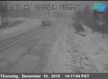

    This was yesterday, I have general altimax tires for my Prius that someone who sold their subaru gave me last year yet still had to chain up while I can get through chain control with the CRV on michelin defenders no chains. Majority of our customers that live up there run either studded or just winter compound tires. [​IMG]
