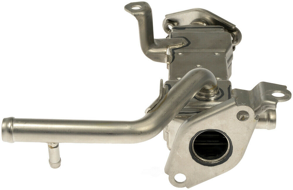

    not much of an inside difference to the original toyota egr-cooler (not even really cheaper) /

  10. ChapmanF
    28,626
    18,956
    Wasn't the whole thrust of that sell sheet that the original is a fin-and-tube design (as seen in the photo above) and the Dorman uses larger spiral tubes less prone to clogging?
    Or is that a photo of what Dorman sells for Gen 3?
    Edit: yeah, it looks like for some makes and models, the cooler they sell is in their "OE FIX" line, and uses the spiral tubes for reduced clogging.
    But not the one they sell for Gen 3 Prius.

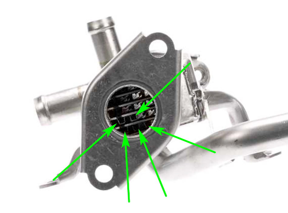

  16. StarCaller
    StarCaller Senior Member
    Feb 15, 2014
    1,284
    733
    Cedar Crest, NM, USA
    hmm, to me it looks like it has the same square cooling canals like the original from Toyota /
    (cropped image is the dorman cooler)
    Raytheeagle and xliderider like this.
