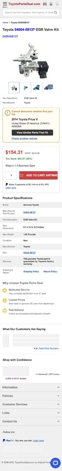

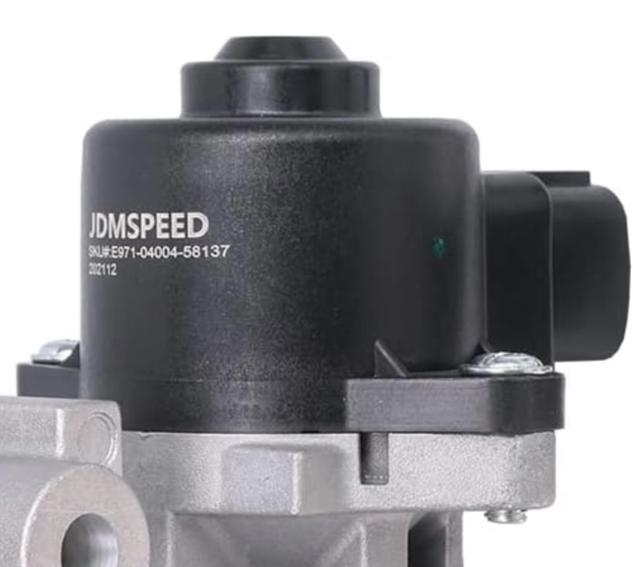

    The alternative sticks and is a bad idea.
    $99 Sticky Aftermarket
    No housing number

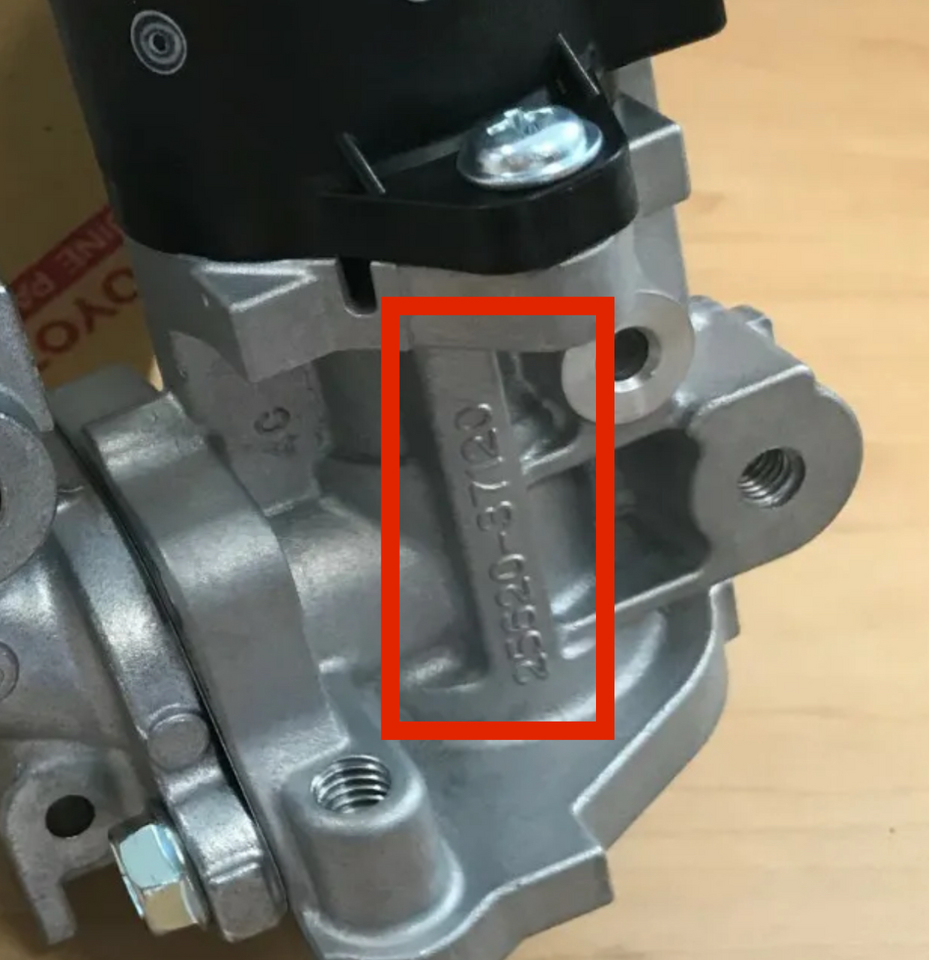

    Newer EGR Valve is 25620-37120
    Egr valve updated Kit 04004-58137 includes 25620-37120 for less money. Even less ($154) from online Toyota dealers.

    A P0401 means one of two things. It could mean the egr cooler is completely clogged or it could mean your egr valve is sticking open. The second cause can be mimicked by a bad gasket downstream of the egr valve but that is rare if no one has been in there.
    Typically a totally clogged egr will cause no obvious problems. There are people here that say the cylinder temps might run hotter but the reality is egr flow at normal cruise reduces emissions. Gen2 had no egr system and achieved low emissions with a more expensive catalytic converter. Some other countries had gen3s without the egr system.
    A sticking egr valve will normally cause some stumbling or roughness at engine idle. The revised Toyota egr valve helps prevent that situation.
    That valve is available for $154 as noted in the attachment above.
    Concerning buying parts vs cleaning; if the egr cooler is totally clogged cleaning can be difficult and time consuming. Sometimes days of futile efforts. Most have never seen a totally clogged egr cooler which means cleaning a slightly carboned up cooler was easy for them.
    Removing the egr cooler and valve is a big difficult job. Do it right the first time.
    I would buy a new egr cooler which I did the first time I had that code. You end up with a spare you can clean at your leisure and avoid long downtime.
    I would buy the revised egr valve as well ASSUMING yours is not already the new part as shown above. Which I did when the original started sticking.

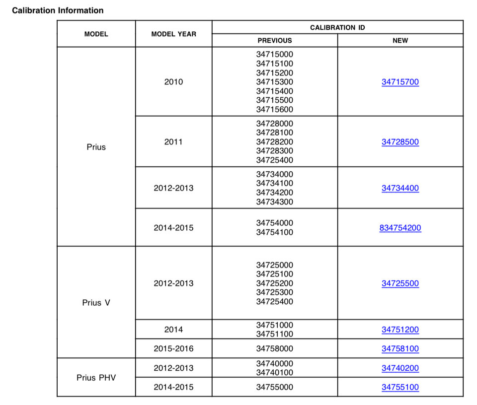

    There's a software update that is mentioned in two different TSBs, one about EGR, one about an intake manifold. You can update to the same software version in either case. The update does not seem to have anything specifically to do with the EGR or to do with the manifold, just a collection of ECM tweaks Toyota thought would also be useful. For more info, there should be about 80 other posts like this one you can search up that are longer and more detailed.

    The latest egr valves (post 2 above) are recommended for 2010-12 gen3 Prii including plugin and v wagons.

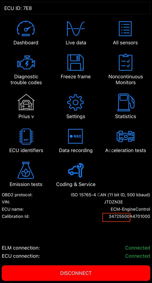

    The latest gen3 ecu code (calibration id) is available for all gen3 Prii 2010-2016 (2016 gen3 is a Prius v only).
    The US code varies by year and model.
    The version in your car can be read by Techstream (old and new GTS+ version) or some bluetooth apps like Car Scanner.
    Car Scanner app
    To update the code requires online use of GTS+ but is best done at the dealer.

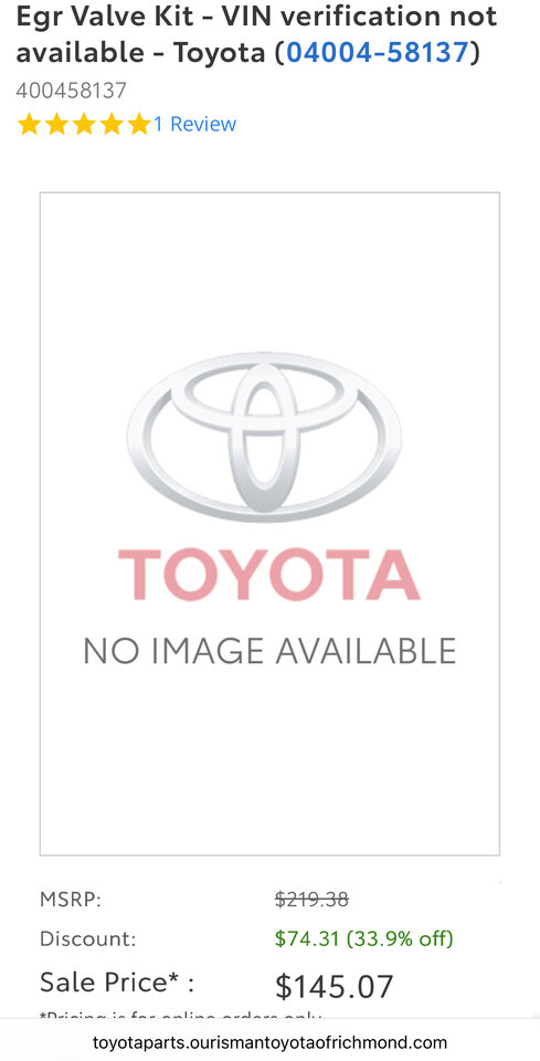

    Lower price on revised egr valve kit, primarily needed on 2010-12 gen3 Prius
    Link here
