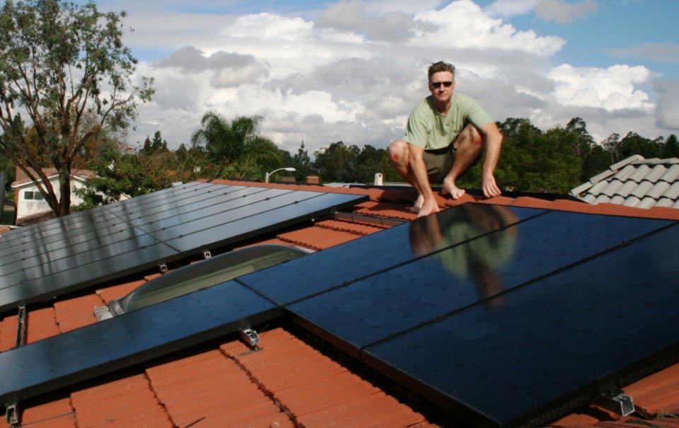

    "Fuel Costs" ... don't forget to throw in the ancilary fuel costs. Oil ... filters ... etc. Your costs to get down the road should include all your stuff. Similarly, the traction pack has a defined life expectancy that you can throw into the mix on the other side of the numbers. We use over $250 month in juice here in SoCal - only we make it our self - so ... since our system's cost will fully amortized itself in just a couple more months, our juice is pretty much free:
    But fuel costs ought to include more than what's in your wallet. What about health costs for burning fuel. How do you calculate national interests (Al Queda ... National Debt/military spending) in the mix. It's way bigger than the paper in the wallet ... unless one is strictly thinking it's just about 'me'.

    Nice photos, but with your thinking you should limit your breathing because your adding to the carbon dioxide foot print
  20. fuzzy1
    17,558
    10,337
    His breathing does not transfer fossil carbon from the ground to the atmosphere. His exhalations are primarily derived from plants that are already part of the atmospheric carbon cycle.
    Only the fossil fuel used to produce it, transferring stored fossil carbon from the ground to the atmosphere, matters much. And if he was eating synthetic food made directly from fossil fuel, then your point would have more value.
