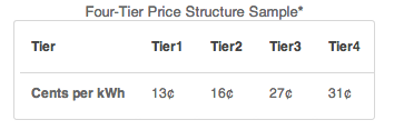

    Okay I reran the numbers in my spreadsheet today. Because it is winter and our EV range is down to about 11 or 12 miles, I am averaging up to 12. Summer, I assume 13.5-14 miles of EV range.
    A full charge with 100%HV is 2.9 kWh (with charging losses, as displayed by a charge point station in my area). If you run the HV down, it may get up to 3.0 or 3.1 kWh.. YMMV.
    Petrol prices in SoCal are around 3.49 / gallon
    PETROL: $.0698 Cost Per Mile (CPM) | $3.49 / 50 Miles
    SoCal Edison Energy prices:
    TIER 1: $.0290 CPM | $1.45 / 50 Miles
    TIER 2: $.0387 CPM | $1.93 / 50 Miles
    TIER 3: $.0653 CPM | $3.26 / 50 Miles
    TIER 4: $.0749 CPM | $3.75 / 50 Miles [EV MORE EXPENSIVE]
    Note this is only winter calculations.. in the summer because we achieve more EV range, and gas tends to go up in price, EV miles are cheaper.

    Well done. I was curious what the actual $/kWh is is SCE. This is from their website:
    Once you add in taxes and fees I estimate the marginal rates are some 10% higher so 2.9 kWh of tier3 costs about 86.1 cents and tier4 costs 99 cents. For 11 miles that works out to 7.82 cents a mile in tier 3 and 9 cents a mile in tier4.
    This analysis shows clearly why EV in CA owners tend to also put up PV as a $ consideration: Paying for EV miles in tier 3 or 4 is not pretty.
