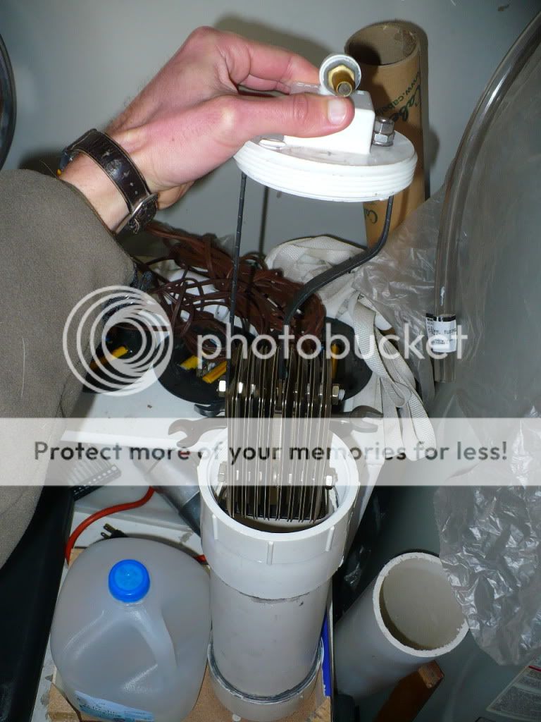

    I used the Smack plans and built it myself. It's the one with the 4" PVC enclosure and the stainless steel wall plates. I mix the NaOH electrolyte so that the chamber draws about 15 amps when warm.

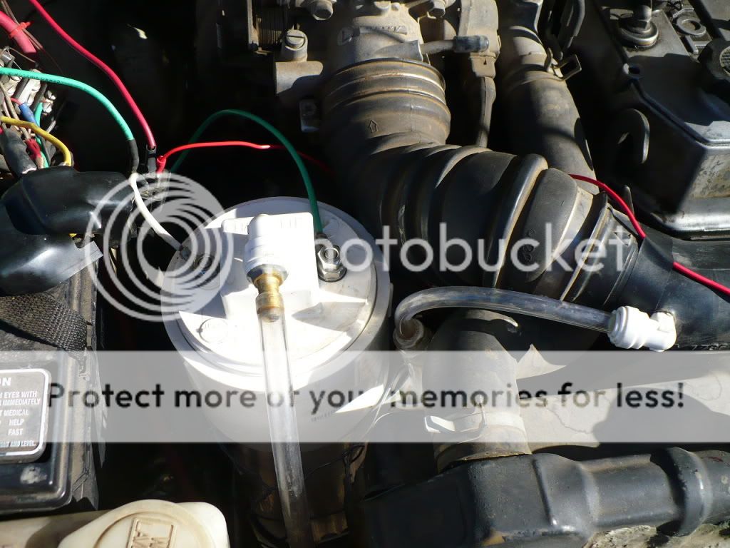

    Here's my Smack booster and '85 Toyota 4wd with the 22R-E 4-cylinder installation:
    The 12v relay is just above and to the left of the chamber in the photo. The small red wire comes from the ignition circuit and is wired through a dash switch (and fused). The bubbler tube is running down the right side of the chamber. It uses windshield washer fluid so it doesn't freeze. The outlet of the bubbler feeds into the intake between the air filter box and throttle body.
