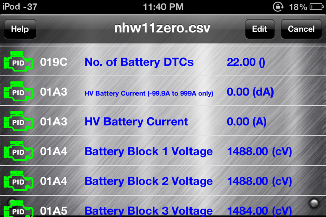

    For the individual cell block voltages that should be 14.28V. You can add "divide by 100" to the equation, as Jghake suggested, to correct the values.

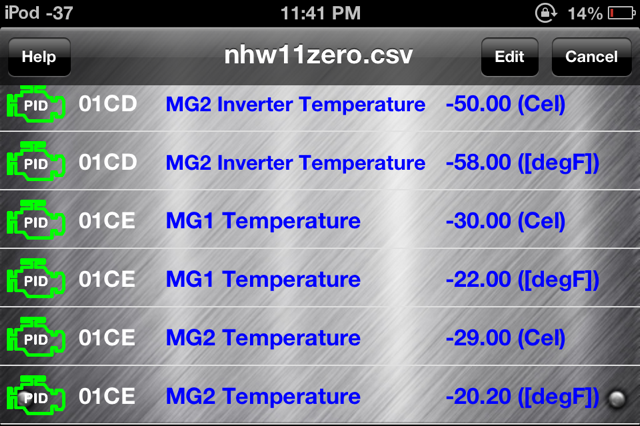

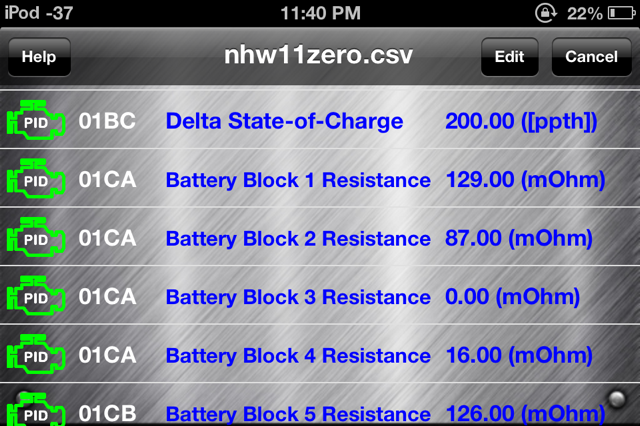

    I had the same thought. I pulled the standard list off the app, and opened it up next to yours. Then I just transferred the new data over to the standard list, using the exact same column names and order. I wanted to make sure the formatting was the same, just to eliminate variables.
    And it worked. The vast majority of the PIDs lit up, but a lot of them (especially temperature-related) gave nonsense data. I attached a few screen shots. Ambient temperature was probably low 20's Fahrenheit.

    Yes, it looks like it is reporting temps in the 0 F range to be giving the negative F values.

    Yes, the cell block voltages that I saw looked comparable. You just need to divide by 100.

    One thing that I noted on your pictures is that the No. of DTC's indicate 22. Try to clear the DTC's and see if this changes.
