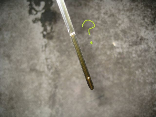

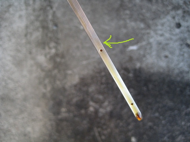

    This is for you, because you are so awesome Bisco. I checked my oil today. The engine has been sitting about an hour after I came home from work. From picture 1, I have no idea what my level is.
    Flip it over and ahah. I'm a little above full. No, it's not below low. I know it looks that way. It's tough to see in the picture and tougher still to get a sharp focus but in person it's obvious. To give some context. My PiP has 19.5k miles. I got my first free oil change at 10k miles so this oil is pretty much spent. I'm impressed by how clear the oil is. On my previous cars, it would be much much darker. This doesn't mean the oil is still good, it's just an observation.
    If this was new oil, I would have a tough time seeing the level. And finally, 10k miles and I am still reading above full? That's about a 1/4" I would say. Looks like we both need a new dealer. If I remember, I'll take another pic in two weeks when I get my next oil change. Let's see how difficult it is to read. Might just have to use your fingers to read it.
