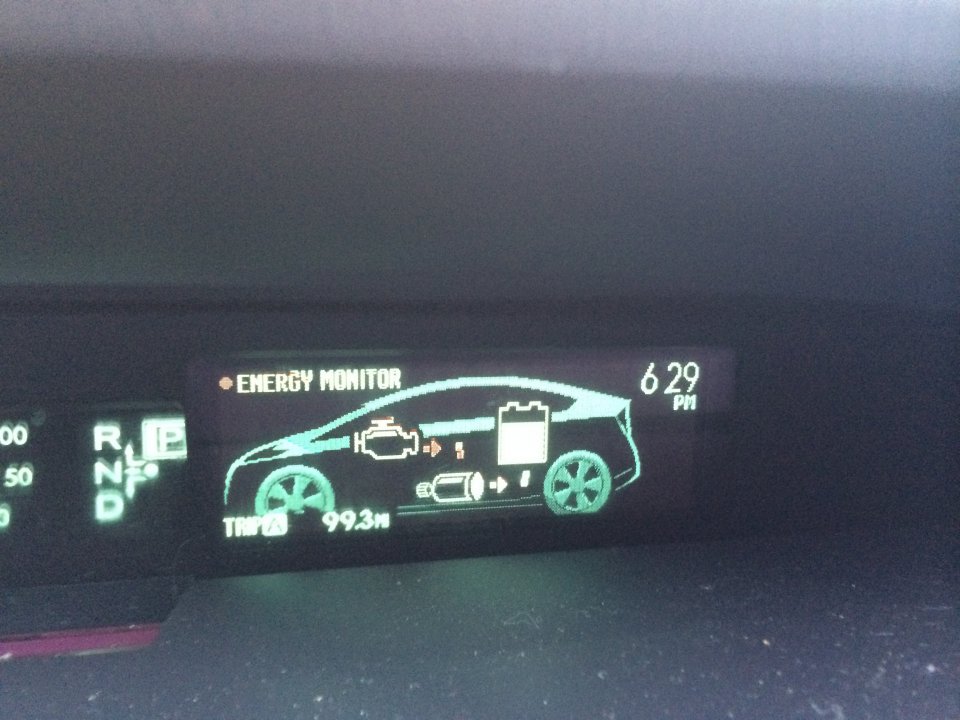

    Yeah and on the MFD, when it's on the picture of the car, when the engine will not turn off the arrow from the engine to the battery is not there. Mind you the battery is half to full

    So nothing has changed but this can somewhat explain my problem. That battery is being charged when then battery is charged when it's not even low. And when the car acts when you drive it, it seems like it's using the engine only.
