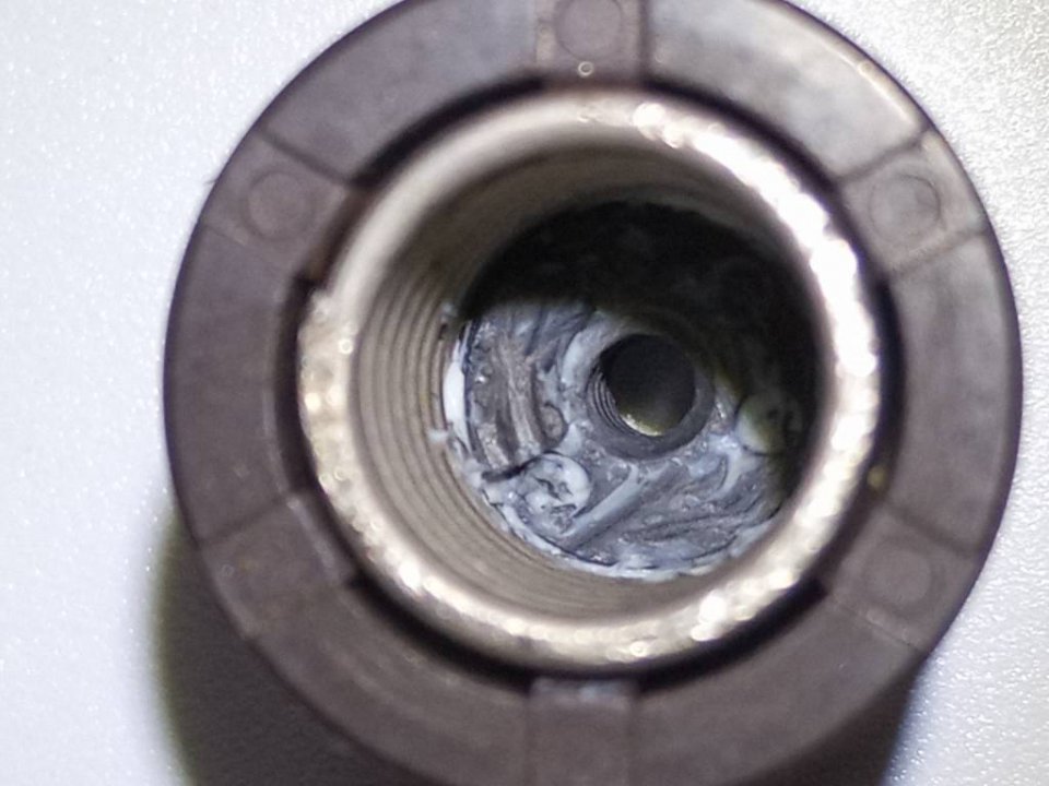

    thanks, well it does not look the best, take a look, is this part available separately ??

    It would be a little easier to see if some more of the grease were wiped out, but yes, that does look mashed.
    If so, you should not reuse that valve. It will never open enough, and will always deliver too little EGR.

    Hi Guys, thanks for all your input, is that wear and tear ? or have i overtightened it after cleaning the egr ?
    spewing if you cannot buy it separately, i'll try and build it up with super glue and baking powder, before throwing a whole one on.
  8. ChapmanF
    28,375
    18,772
    Wear and tear. You probably couldn't do that by yourself, reassembling the valve, unless you heated up the rotor in an oven first and then cranked it down really hard. :)

    does anyone know if the "ski slope" is used as a slope or is the end of it used as a "stop" ?
  10. ChapmanF
    28,375
    18,772
    The end of it is used as a stop.

    I'm not sure what you mean by this. The ski slope is on the inside of the rotor. The spring is on the pintle shaft. The pintle goes through the valve housing in such a way that the pintle isn't turnable (or sure shouldn't be, anyway). It only moves straight in and out. That means when the rotor spins on it, the pintle does not spin, and the threads force it inward or outward.
    If you spin the rotor on clockwise from the end (as you are spinning it onto the shaft), when it gets to the bottom it (the rotor) should stop turning with a solid positive 'tock' which is when its ski jump hit the raised nib on the disk located on the pintle shaft. If the ski jump has a rut through it, there will be more of a scrape and the rotor won't just fully stop at that point.
