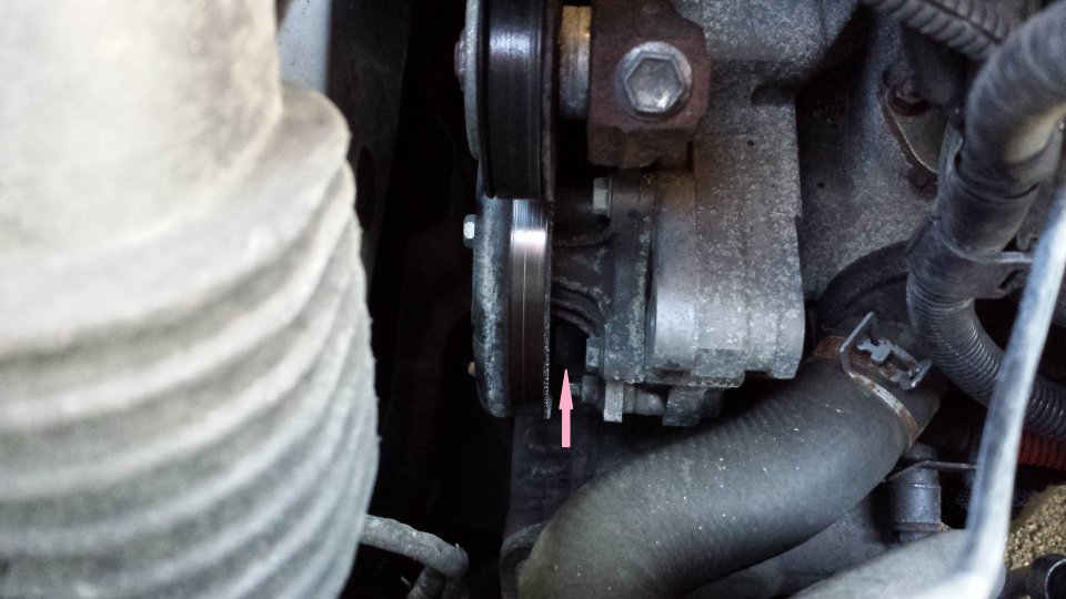

    Hello all,
    Happy holidays and soon to be new year.
    I took my 2007 prius (96000 miles) in today for an oil change. Dealer tells me there is a leakage in the engine water pump. Not the electric one but the engine one. He shows me a very small amount of pink coolant. He stated it just began. I find it coincidental that it just began because at 92500 miles, they replaced my serpentine belt. The picture is hard to see where the leakage is, but its a small amount right at the pink arrow. They quoted me to replaced the water pump $506 bucks. I asked him what is wrong with it, he stated the gasket is worn out due to time and usage. I tried to reason it out and I said ok since i am at 95965 miles. But what I have a tough time believing is the legitimization of the diagnosis. On the last oil change, they replaced the serpentine belt. This oil change they tell me the water pump. They said, "IT JUST STARTED". Am I being taken to the cleaners here? I am just an average jane and don't know much about cars. Please check the picture to see the area of the leak. Its very small amount.
    second, is $506 reasonable for Newark, Delaware? Anyone have a good recommendation in the area? The water pump is not leaking, he said its just the gasket wear and tear. Replacing the gasket takes $506?
    Thanks for all your replies in advance.

    The coolant leakage is due to a failing coolant pump bearing seal. Yes, it looks like the failure is recent.
    The problem is not a failed gasket. The pump must be removed and replaced with a new pump. Check with other Toyota dealers in your area to see what the prevailing pricing is.
    An independent mechanic could replace the pump - but a special technique is required to purge air out of the engine coolant system. Hence I do not advise that unless the independent specializes in Toyota hybrid vehicle repair.

    I've read many times from owners who replace their belts, the water pump begins to leak shortly afterwards.
    There are write ups on here and even youtube showing how to replace this yourself, it's takes about an hour and part costs about $45 on amazon for the aisin manufactured oem pump.
    This would be a good time to change out your coolant as well since it's recommended every 100k miles.
    The leak is actually pretty minor, you can monitor the coolant level and top off the fluid for a while. It's a very very very slow leak
