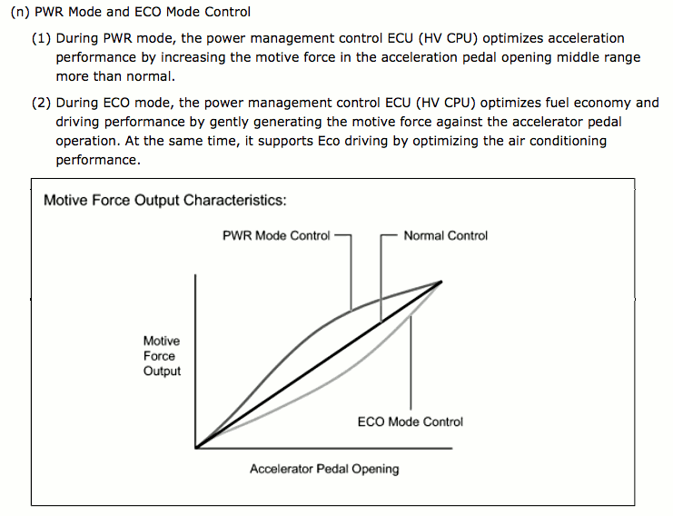

    if none of the driving modes selected, how the prius consumption profile? Is it between eco and pwr or same as eco? and is there any technical data/graph which compares these modes and consumption difference?

    No mode is actually called Normal mode, with no mode lights on.
    The only difference between Eco, Normal and Power is the remapping of the accelerator. Eco will require more pedal travel over the first half for the same power output. Power mode requires less pedal travel for the first half for the same power output. Normal is in the middle of theses two. You get the same total power output in all modes. It just depends on how far you have to move the pedal to achieve it.
    Eco also adjust the AC for more efficient use and mpg. Eco is also easier to use for high mpg and for feathering the pedal to get in to what is known as glide mode with no regen at all when letting up on the accelerator.

    Yes there is a graph showing pedal position vs power output. Unfortunately it is buried among all the old threads and I don't remember it's name. We referred to it quite a few times when the Gen3 first came out in the summer of 2009.
    The graph shows pretty much what JD said in his post. Power mode tries to make it feel sort of like a lot of non-hybrid cars with most of the power delivered during the first 1/2 of the pedal movement. ECO takes more pedal movement for the same result during the first 1/2 of the pedal range and is good for finer or more delicate control. Normal is between the two and about the same as the Gen2 Prius. As JD said the amount of total power available at full throttle is identical in all 3 modes. EV mode doesn't have much (if any) value due to the speed and operating temperature restrictions placed on it.

    The consumption profiles will differ from driver to driver because the modes were designed to help the owner get the most out of the vehicle. For example, a lead-footed driver may get better mpg in PWR mode than in ECO mode because the accelerator mapping of PWR better fits his/her driving style and in ECO mode, they're fighting the pedal to accelerate faster.
    The advantage of ECO mode is the reduced power consumption of the A/C compressor in the summer and more aggressive engine shut off in the winter. In both cases, it will take long to cool/heat the car because of reduced climate control output but you can increase fuel economy that way if you drive normally.

    The graph. From this thread. ( I found it with this google image search-- site: priuschat.com accelerator map graph )
    It's interesting to hold the accelerator pedal steady and press the Power or Eco button. It smoothly adjusts the power within a few seconds to match the new mode's settings.
