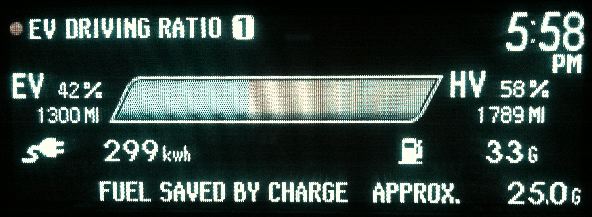

    As long as on this screen (there are two of these, see it says 1 after EV driving ratio. There is a 1 and a 2) it has not been reset since the Odometer was at zero the EV miles and HV miles should add up to your odometer reading. If they do not then the ratios were reset.
    I have kept my ratio 1 screen complete since buying the car and never reset it so mine add up (well, I think it is off by 1 or two miles since I reset it once home so it's off by whatever my odometer was at when I did the reset after getting home. Then, ratio 2 is the one I use to reset before trips or after fill-ups.
    And the Odometer reading can be seen on two screens, shown below. It will say ODO before the total odometer reading, which of course cannot be reset.
    Just fyi, these are just random pictures I have so the mileage I showed in the first pic ratio screens will not add up to the odometer readings I show later....

    Ok I just went out to my car to confirm Brooke.
    Sure enough, on my EV Driving Ratio screen when I added up my EV and HV miles I got two miles less than my current ODO reading since as I mentioned above, I had reset ratio 1 when I had 2 miles on the car after bringing it home. So if yours is not adding up, on either screen, they were reset after there was already miles on your odometer.
