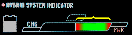

    Are you saying 3/4, or 7/8, of the entire HSI or just the ECO half?

    The Eco half.
    From Hobbit's page:
    HSI

    I believe he (Wayne) is talking about the wide portion, not including regen or pwr. I do wish they had included a shot of the HSI instead of the useless shot of people's feet.
    An image from Hobbit's page (you want to be in the green section when you are using the ICE):
