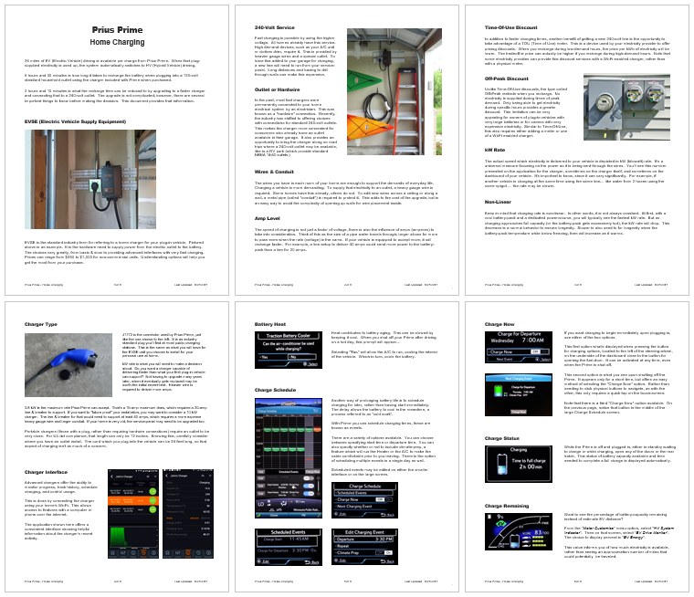

    Both Primes are charging up in the garage now on 240-volt connections at a sustained rate of 3.59 kW.
    Photos of the final setup on the way...

    The brackets worked out great for mounting both the charger and the NEMA 14-50 outlets.

    Great resource, John! Thanks for posting this.

    At some point, I'll be adding real-world data about charging (speed, duration, quantity, etc) & billing (various costs).
    So, if you have something else you'd like to have documented or want more detail about, just holler.

    I'd love to have some of the screens explained in detail. For instance, the last one you have posted above. I have the 'miles' version set in my car. I assume the light blue bars that either go down into the bottom section or up into the middle section of the curve reflect charging vs using. But how about the darker blue section in the middle section of the curve? Why is the middle section divided into 2 when not in EV mode? The 3 driving scores are calculated over what period?
    Maybe I'm the only one here who needs some of the details filled in. If so, i can buy you a beer while I get my personal tutoring session!

    That's coming in the regular User-Guide, which this charging document is just one section of.
    And you're far from alone. There are many who would like the detail too. I've been noting the questions people have been asking, just like in the past when the other Prius were new.

    Explain the white slotted mounting plastic things. In 2012 I bought a 240v 16amp Leviton EVSE for our PIP, which was easy and just came with a template and bracket for installation. I installed 30amp breaker and 10 gauge wiring. Prime is on other side of garage with std 120v cable and set to 8amp for overnight charging.
  20. john1701a
    john1701a Prius Guru
    Jan 6, 2004
    12,840
    5,312
    Those are metal bases that allow you to connect a wide variety of brackets.
    I used them to accommodate screws whenever needed, since studs were not in the desired location.
