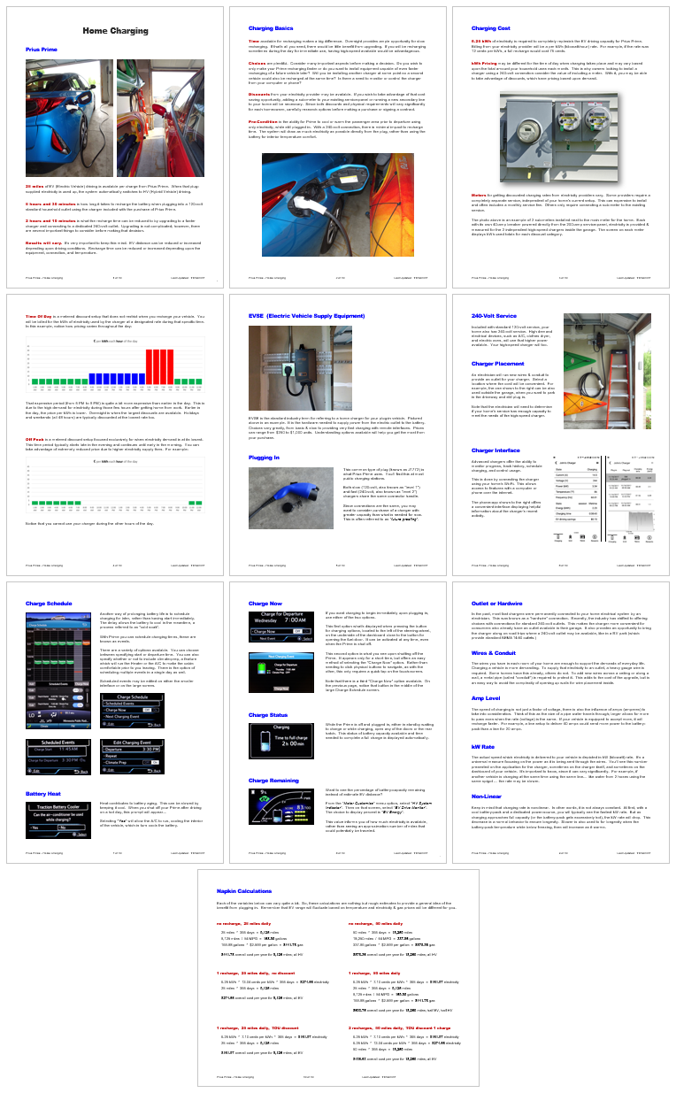

    Looks like PriusChat caches outside images now, rather than pulling refreshed images. That's a really nice enhancement, but I wasn't aware of the change... which means my previous post won't reflect the 3 new photos I added. So, here's an upload of thE document updates:
    John's Stuff - Toyota Prius Prime - Home Charging
    Strange. It doesn't show the update on the regular forum page (even after clearing browser cache), yet I can see the difference in edit mode while typing this. Oh well. At least the webpage hosting has the refresh for 11/19/2017.

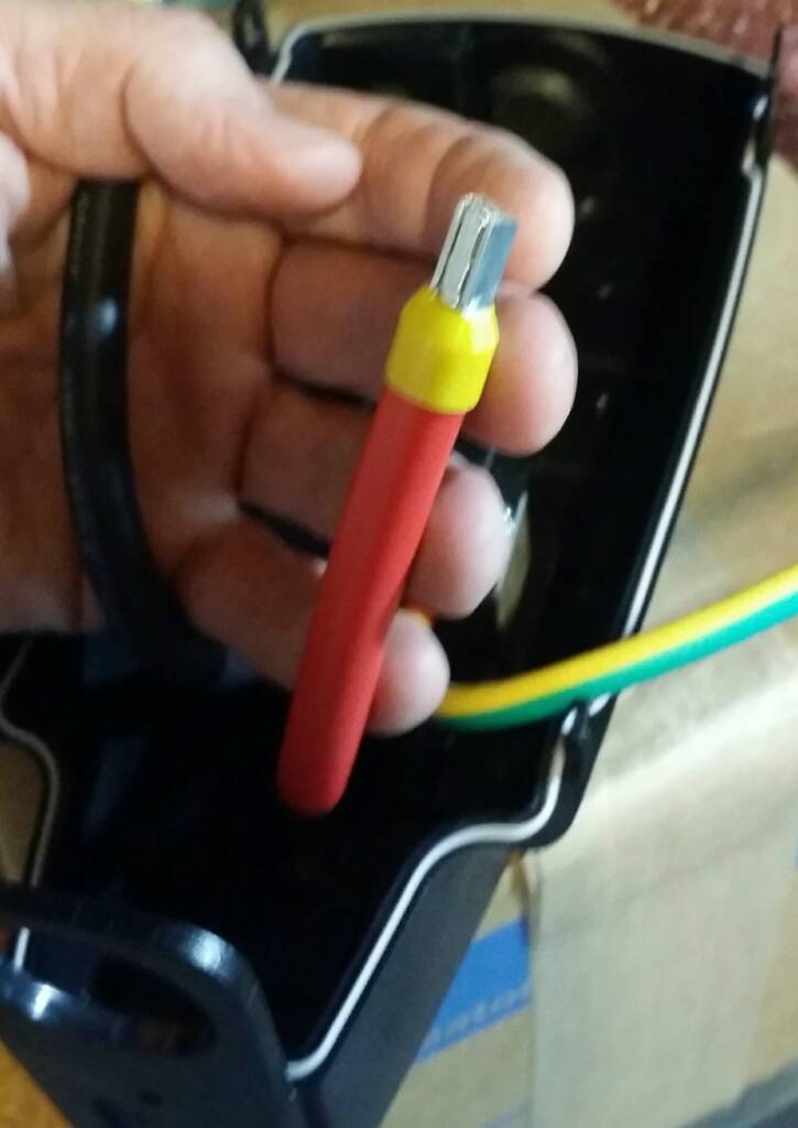

    Reading the instructions on this unit I'm installing right now, I see it can be daisy-chained together with 3 other high-power EVSE's. Wired into a 100 amp breaker, the most power any one EVSE could deliver would be 25kW, presuming 4 cars were charging simultaneously .... or 2 cars could receive 50kW.
    I'm not regularly wiring such heavy duty stuff. I must say - looking at this number 2 wire, virtually the same size as my pinky finger, it's sort of blows me away.
