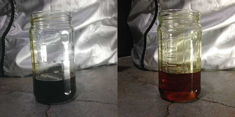

  12. Mendel Leisk
    61,446
    42,287
    I'd agree that oil appearance on the dipstick is much cleaner with Prius approaching oil change time. And that must mean something.
    Still, doing (DIY) oil changes every six months or 8000 kms (Canadian third gen schedule), and this is with months governing, only about 5000 kms if that: I've found a sample of the drained oil in something like a jam jar, is black as ink already.
    I appreciate that means it's doing it's job, and again, it still looks good, as a thin film on the dipstick.
    #52 Mendel Leisk, Jan 17, 2019

  14. Mendel Leisk
    61,446
    42,287
    ^The one on the right above (per the previous post) is new Toyota 0W20. The one on the left is the same oil, after about 4000 kms. Are you saying the oil on the left is "clear and translucent"??
    A couple more pics, in better light. New Toyota 0W20:
    And again, after around 4000 kms:
    #54 Mendel Leisk, Jan 17, 2019
    Preeeus likes this.
  15. jack black
    jack black Active Member
    Jan 5, 2018
    225
    142
    I
    sorry i thought it was the same under different light. it got darker alright.
  16. Mendel Leisk
    61,446
    42,287
    Yeah first picture was in artificial light, and a little odd, two superimposed pictures. Suprisingly: if I check the dipstick on the oil just prior to oil change, it looks quite good. And yes, conventional cars, same scenario, the oil even on the dipstick looks terrible. But with a larger volume of oil it's a night-and-day difference, between new and just a few K miles. Again, that's a detergent oil doing it's job.
    But still, I like to err on the side of caution: third gen Canadian schedule is 6 months or 5K miles (8K kms). Fourth gen, they set schedule same as US: 12 months or 10K miles. At the end of the day (don't you hate trite euphemisms...) it's up to you, when to change oil. (y)
