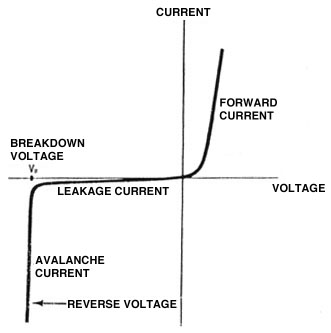

    I just want to correct a misconception here about diodes. Back a ways in this thread it was stated that diodes wouldn't let a backup battery fully charge....
    Voltage drop across the diode is a function of forward current. It's typically 0.7v for a silicon diode at some specified forward current. Take a look at the voltage vs current graph for a typical diode at this web page.
    As the backup battery approaches full charge the current will drop towards zero and the voltage drop across the diode will also approach zero. The backup battery voltage will fully charge and the charge will taper off as it approaches within 0.7v of the primary battery (due to the diode voltage drop) but will continue to charge slowly until the voltages match.
