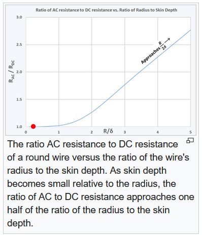

  13. fuzzy1
    17,813
    10,602
    At 60 Hz, copper skin depth is 8.5 mm, or 17mm diameter. That would correspond to what gauge -- about 7/0? The charts I'm seeing stop at 4/0.
    For the wire gauges used for household extension cords, this "current is concentrated on the surface" effect is de minimus.
    PS. Here is wikipedia's skin effect chart. The red dot is an approximate marker of where 12 gauge 6 gauge [edit: I initially confused radius vs diameter] copper wire lands for 60 Hz:
    #33 fuzzy1, Jan 28, 2024
    sylvaing likes this.
