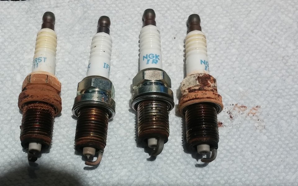

    Next day I have removed the wipers, plastic cowl, relay block, and metal tray to get a better access to spark plugs. Plugs were replaced (by me) at ~ 105k, so it was a time. Out of 4 plugs 2 were very rusty (cylinders 1 and 4), see the attached image. 20150322_185539.jpg

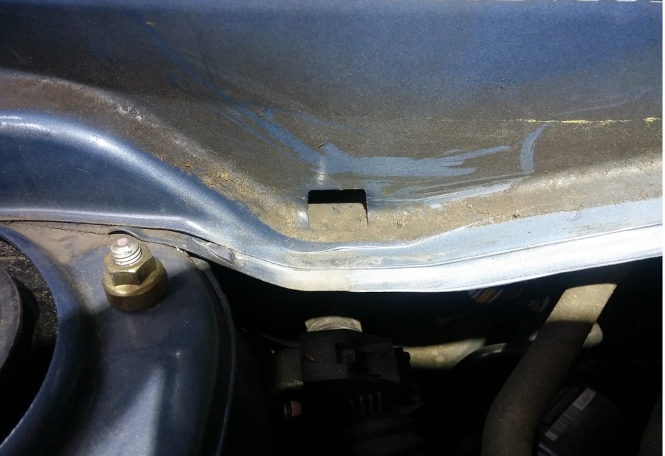

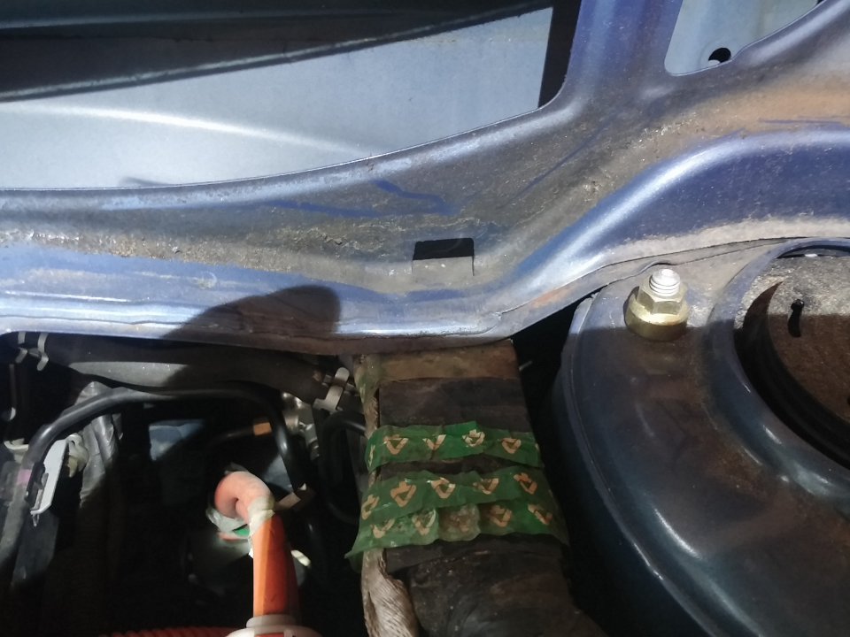

    I'm glad I replaced them. The rust was nasty. The ignitor part was in good shape (as you can see, minor sand-colored deposits only, 55k miles on them). I had to use the vacuum with attached thin hose to get all the junk out of the spark plug wells and even from cylinders. As it was mentioned before at PriusChat, rain water from windshield runs down to the cowl and then somehow gets onto the engine top. I will probably apply a bead of sealant between metal tray and plastic cowl where they meet, to avoid the leakage in future. Also, the drain holes that lead water down from the cowl were sealed with junk.I cleaned them up. Sorry I did not take a picture of dirty drains, only the cleaned ones.
    and the other side
