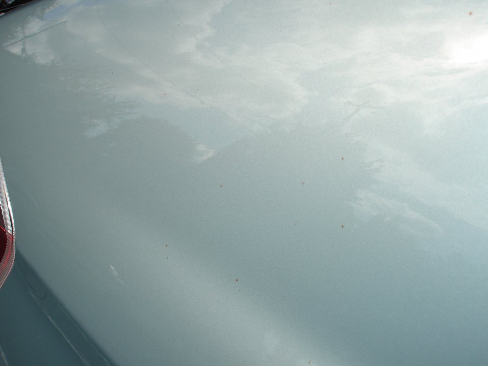

  10. The Electric Me
    The Electric Me Go Speed Go!
    May 22, 2009
    9,083
    5,801
    Undisclosed Location

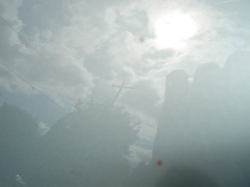

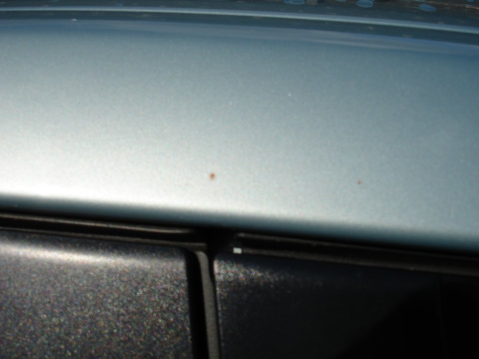

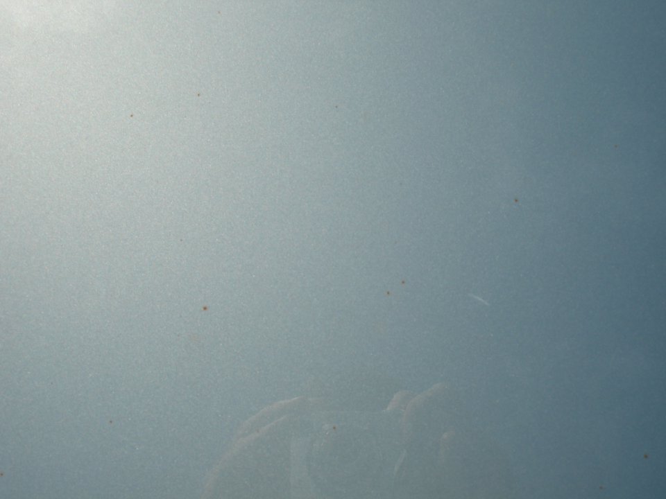

    View attachment 58014 View attachment 58015 View attachment 58016 Thanks everyone that responded.
    I'll just try to blanket answer some questions.
    No Pictures? Because Toyota's response just happened yesterday, and I wrote the post at about 1:eek:o am, and I was venting. Really didn't feel like posting pictures. I can and will.- There isn't too much to see, they are just rust colored spots that appear to be under the clear coat.
    Also, I agree that it is quite possible this material IS something that somehow fell on my vehicle. Even if I don't have any idea how it would of happened.
    When I approached this process, I wanted to try to see if Toyota would cover it under warranty, I wanted it documented, in case it was rust coming from underneath ( I think it isn't...but nobody IMO is really sure ).
    I should be clear, that I understand and accept that "Bad Things Can Happen To New Cars". And maybe that is the case here. My disappointment in Toyota isn't really based on the ultimate denial of this being a warranty issue, it's the fact that they started the process, doing things under warranty...and then changed the definition. I personally think there is enough gray area here- where if I was Toyota I'd side with the customer. I certainly feel that if you start a process of remedy, as a company you've accepted responsibility and should continue to resolution and remedy. It's the "second" inspection, without me present, and the redefinition of the problem and withdrawal of support that has lead me to disappointment. But I accept that these spots actually may be some type of incredibly evil industrial fall out, and of course their attachment and evil penetration of the Toyota clear coat isn't Toyota's fault. But the bottom line to me, is I believe no diagnosis given so far is 100%, and starting the process of remedy, I believe should signify taking responsibility for complete remedy. Redefinition mid-stream, was a "sleazy" way of Toyota getting out of warranty coverage.
    I suppose I would say I'm also incredibly disappointed in Toyota Clear Coat. Like I said, especially with a new car, I'm very, very active in keeping it clean, and this pass summer I was enjoying cleaning it almost every weekend. So I know that whatever landed on it, wasn't on it for more than a week. I've never had a vehicle that had something like this happen to it. Whatever the substance is? The Clear Coat failed miserably at repelling it. I waxed the car about 2-3 weeks after I initially got it, then I was washing it by hand almost every week, I think I let it go 2 weeks once or twice, but NOT the week I first discovered the spots. I've been using, as I have used for years Meguiars Gold Class Car Wash. So anyway, as an Owner, I think my actions were above the norm for finish maintenance.
    As far as why would Toyota think an acid wash would remove something "beneath" the clear coat? Well on the day of the initial inspection I was told that the acid wash actually "lifted" contaminates out of the clear coat. I was dubious of the definition, but when you are trying to go step by step and get support and warranty coverage, you are forced to accept the definitions of Toyota. They wanted to do it, They recommended it. Since I THOUGHT they had accepted responsibility and were going to help me all the way to resolution, I let them do it, thinking the worst case scenario would be failure, probably followed by repainting or replacement. I didn't think the reality would be failure of the acid wash...then Toyota backing out of any support.
    Whether you agree with me or not, I'd like to thank everyone that responded. Yes...it's only a car. I'm disappointed in Toyota. But I'll continue to make decisions and one way or another, I'll reach resolution.
    I am sorry, I know that when ever anyone post's a "problem" people want pictures. I'm really old school as far as technology. I thought "Blue Tooth" was a dental condition. I'll try to attach a picture or two.
    Ignore the links above....technology FAIL on my behalf. Here Spot 176.JPG Here Spot 176.JPG Here Spot 177.JPG Here Spot 181.JPG Here Spot 187.JPG Here Spot 176.JPG Here Spot 176.JPG Here Spot 177.JPG Here Spot 181.JPG Here Spot 187.JPG
    Prieth likes this.

    As I suspected it's a light colored car.
    It's almost certainly rail/brake dust or some other sort of metallic contamination. I'm on my second white car in a row and it's quite obvious on them. You were right to think clay bar, but sometimes it takes either a more aggressive clay than you'll find at the local parts places, or maybe even a machine polish job. If you are not up for learning how to do this yourself, look for a referral to a competent detailer in your area. Not the dealer, probably not someone at a gas station. This person should be able to examine the car, try a test area, and quickly determine the right course of action.
    It's doubtful it's below the clearcoat, but it may be IN the clearcoat now. A light polish with the right tools and abrasives will probably clean it up no problem.
    Out of curiosity, what are you using for wax? Regular carnuba wax is almost useless for protection, as it wears off within weeks. Modern synthetic polymers are easier to apply, last longer, and provide better protection. I would consider trying one of them once you get this sorted.

    I am 99% sure that you don't need a paint job. I get that stuff out of our cars all the time. The clear coat is generally quite thick, so there is a lot of material to work with when polishing. Again, this isn't really a Toyota issue or an issue that the dealer is experienced in. That's why you aren't getting results. You need a professional detailer.

    An acid wash, despite its name, is a relatively gentle wash, and it's effectiveness entirely depends on the product and concentration used. Dealers like it because it can get some results with little effort. In your case, you need something more advanced. If you would like to disclose your location, in pm if you prefer, maybe we can help find someone who comes highly recommended, or at least refer you to the sources online who can.
