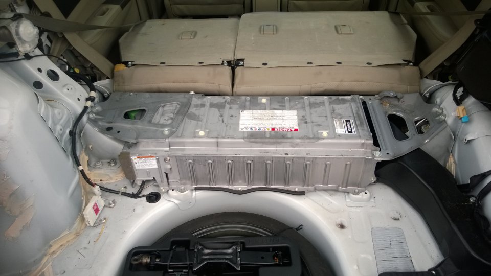

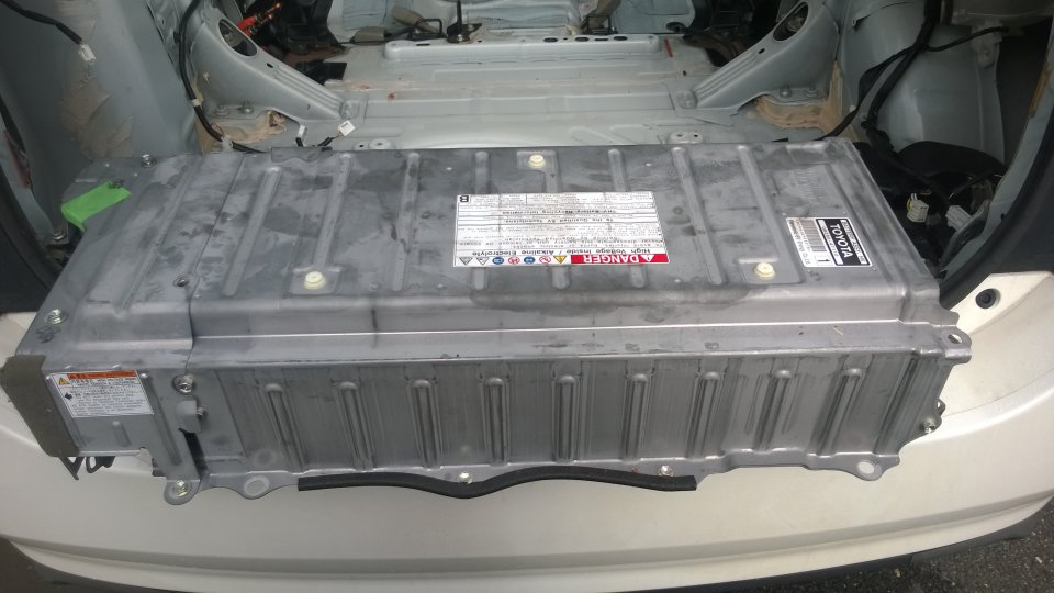

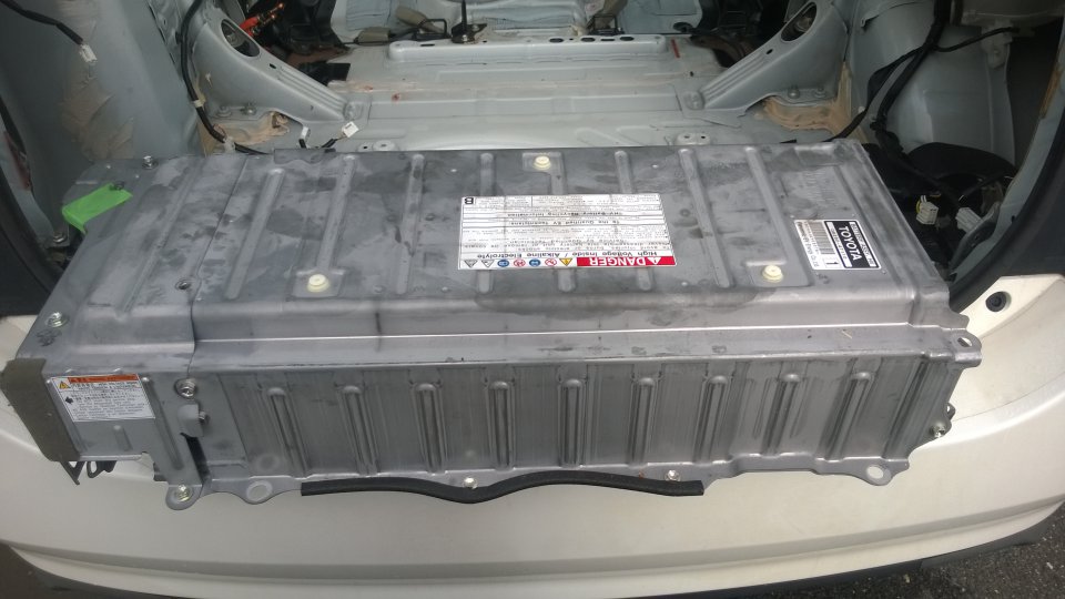

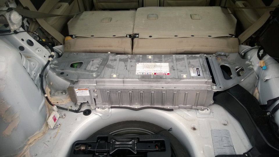

    Just posting this as it may help others. After 253,000 miles my 2006 finally threw the dreaded "Replace Traction Battery" code. I knew it was going as it had thrown this error before, but after driving the car for a few hundred miles it held together, but finally it died. So like many others I was faced with what to do now. I refuse to pay dealer prices, and while I might buy a used Transmission for my Dodge from a yard I'm not buying a battery from one. After hours of searching this forum and others I came across Prius Rebuilders they are now known as Falcon Hybrid Solutions. Much to my delight I discovered they were only about 90 minutes north of where I live in South Jersey, these guys are in North Jersey. They have a pretty good how to video on replacing the battery. I was in pretty big rush to get this fixed so Sunday afternoon when my Prius died I watched the video, and within about 1 hour I had my old battery out loaded in my truck. The next day I called them to verify they had one in stock, I opted for there "Middle Tier" battery offering that is a GEN 2 Pack loaded with GEN 3 cells. This option is 1350 bucks 400 bucks more than the standard rebuilt Gen 2 Pack with Gen 2 cells they offer, however it seemed like the better way to go. With this unit they offer an 18 Month Warranty but it also has a 50000 mile cap (I think it was 50000). I am told the Gen 3 cells have 20% more capacity than the Gen2 cells and since these are used cells they are not as old as the Gen 2 so logic dictates they should be in better shape. Replacing the Pack was simple, took about another hour to put back in. One thing I will note, it's important when you put the Orange Safety disconnect back in you slide the handle lock down after you have pivoted it up into the lock position. I forgot to do this and the Battery will not engage if you don't do both motions. Had the new one for about a month now and so far so good. My Mileage was down to about 42 MPG when to original battery was close to failure, since replacing I seem to be up to about 46 MPG doing the same driving route. Time will Tell. I'm not going to go into the rebuild process but they do have a pretty interesting operation. It kind of reminded me of how Apple got started, they run out of a portion of an old warehouse.
    Total Cost with Tax was about 1430 Bucks. Since I was able to pick up the Battery I was able to avoid the 200 Shipping Charge. Also if your doing the shipping route there is a 400 core on the old unit.
    I'll post again as I put some miles and months on this unit.
