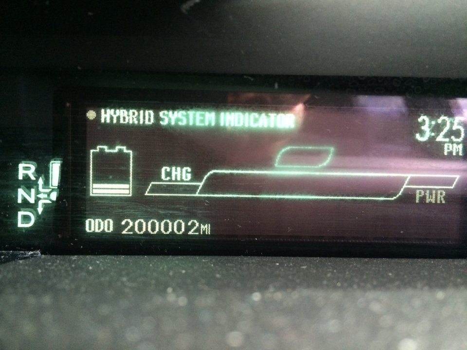

    Happy 200,000 miles without a break down! Yay!! Detail coming soon.

    Ok, so not everything is perfect in the Queen Killer Bea. Some issues are on the foreseeable horizon at 200k. Importantly, I still get great gas mileage, great performance and while averaging 43mpg taxi miles. Still happy as a clam.
    However, the bad news.... She is losing oil. It isn't a leak, it's the piston ring(s). I add about 1quart each 2,000 miles/ or 1week. Eventually I will have to replace the ICE. That will cost @1,500 for a savage engine, and @1,000 for the labor from a shop I trust.
    Also, I battery is on the way out. I can tell because the EV mode no longer works. Also the charge is often low, especially as summer heat cycles the battery. This battery will likely soon have to go as well. Perhaps in the next 50k or so I will have to bite that bullet. That is ok because this car has given me the ability to provide for my family, and soon I will be purchasing my first home because of the value that this car has brought to my business and my life.
    Prius people we know... It is better here.
