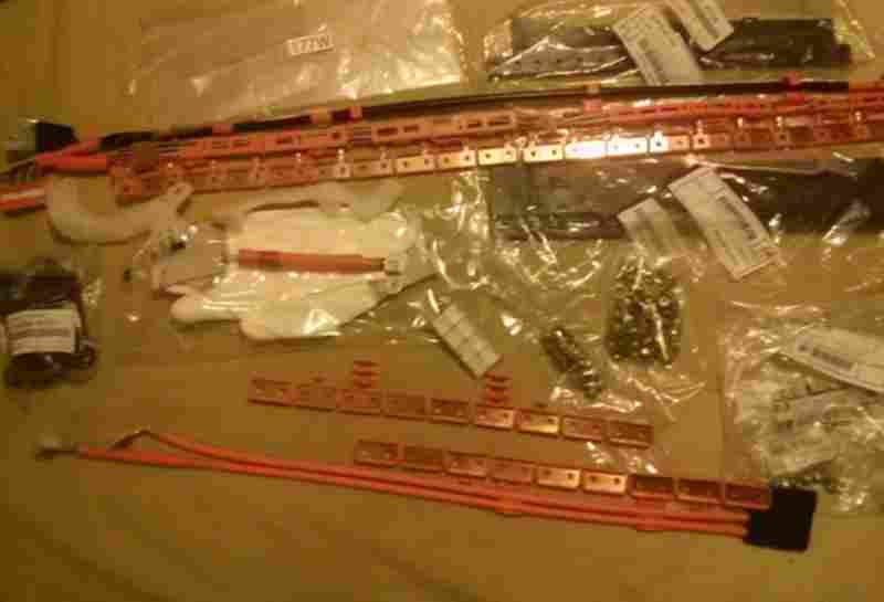

    IMPORTANT: Chap, you mentioned earlier that the kit INCLUDES the wire harness that I need IE pic of the fried harness that plugs into part: 89890-4703 ECU (Computer Assy Battery) see link to pic below..did i read that right??????
    The 40g kit: 04003-35147 Has arrived at the Toyota Dealership
    I want to make sure i'm taking a hike over there for the right parts!! Am i missing something here....The Toyota parts manager said he looked in the box (besides the bus bar & plastic pieces) the 40g KIT only contains ONE very long wire harness with only ONE plug in piece attached...(doesn't the correct harness come with a 24 pin male part (which plugs into my large ORANGE 24 pin female part on my ecu) AND a smaller 8 pin male part (which plugs into the small white plastic female part on my ecu) and he doesn't THINK the kit included wire harness is the one im seeking..(does the one in the kit need to be assembled further? that would explain)

    The 04003-35147 kit that your dealer is holding for you has the right stuff in it. The orange (believe me, it is originally orange, not black and crispy like yours) 26-pole plug is hanging off the front busbar assembly.
    The ECU might also have a white or other color plug attaching to it for the five or so temperature sensors spread across the top of the row of battery modules. That wiring is not included in the kit. If yours is ok, you can reuse it - if not, you'll need to order the battery thermistor wiring (I'm expected for lunch so I'm not jumping over to Village Toyota online to look it up just now). With any luck yours is ok.
    All of the wiring needed for voltage sensing and carrying power within the battery is included in your kit.

    Ahhhh I just seen this message~! so the kit does have the correct harness (hurray!!!) and the missing small white plug in i need to order separately, OK mystery solved!!! THANK YOU CHAP!!!
