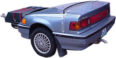

    The i# REX uses an ICE from BMW's motorcycle line. Not as clean as a car, but motorcycles do have a 3 way catalytic convertor installed now. Most home built pusher trailers are just a FWD car cut off after the firewall. It's why I suggested your current gen1 as a possible donor. A mid or rrear mounted engine donor car would be easier to keep the existing exhaust and emission controls intact without modification.
    [​IMG] [​IMG]
    If towing is a must for this vehicle, and not just pass towing duties to the gen3, then scratch off the i3. As I said, it uses a motorcycle engine, and is also light weight. Without disabling the CARB hobbles, the ICE will only come on when the SOC is near empty(20% I think). At that point there isn't enough reserve juice in the battery to drive the car up extended, or steep inclines, and maintain its regular power output. If it does have the power to tow, the brakes designed for its weight likely won't be enough combined with a trailer.
