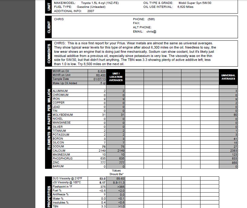

    You can always over analyze it like the guys over at bobistheoilguy.com and do UOA (used oil analysis).
    mtbiker53 and PriusGuy32 like this.

    I agree! They are a great guide, instead of guessing.
    Heres my last UOA:
    nodrogkam likes this.
