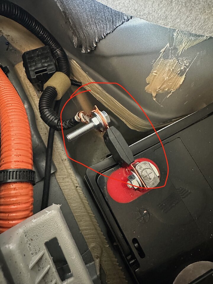

    Battery size (width) problem. The replacement battery was roughly 1" wider than the original Toyota battery. This caused the replacement to not drop in place but ride "high" and it was getting squeezed from the sides when I tightened the battery down. Today, I finally took the battery out and did the following:
    1. Unscrewed the bracket and drilled two fresh holes in it to get more margin. See the images. The bracket is held down by 3 10mm head bolts. I did not drill 3 new holes; I drilled only 2. I did not do the last one.
    2. Bent the bracket that holds down the battery so that the new angles created due to the taller battery and extra width worked out. The bracket has plenty of margin to work with.
    3. Since the battery was a Nut and Bolt type, the original Toyota terminal adapter with a built-in fuse could not be used, mainly because of the height. So, I used an aftermarket fuse (150A) from Amazon.
    I have been using M6 screws, but I did not have a short enough one for the positive terminal.
    Seems to work.
    Here is the 150A fuse, $3.39 ...
    #610 Arkay, Feb 1, 2026

    Is this in the Prius c that you have listed in your profile? Maybe you should not be posting in this Gen 2 thread as it only adds confusion to Gen 2 owners looking for a solution.
    For example, you talk about adding a 150 A fuse to replace the 12 V positive terminal block, but that block contains a 100 A fuse on the main feed, and you don't say how you've handled the 5 A fuse and sense wire.

    That's a generation too battery tray I guess his fuse is ok it 50A off . Couldn't the sense wire just go to the main plus battery termrt they're with the new 150A fuse . We can buy a UB that fits I've got the part number in threads here on site just cannot remember number. Gonna try like a NOCO type battery shortly . Be smaller thsn stock AGM for sure. I can either do the fuse like this or make adapter for the factory plastic block on the positive.
