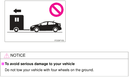

    No, like with an automatic tranny connected to a gas engine, the oil pump for the (non Prime) tranny only operates when the engine is running. So, without the engine running, the tranny gears and bearing would take a lot of heat and wear, eventually causing an early failure.

    I would say, if you're going to insist on trying it, first learn the speed above which your specific Prius generation has to run the engine while coasting, and keep your towing safely below that speed.
    If you're not going to insist on trying it, you can just follow the owners' manual, which says not to.

    For each generation of Prius, there is a specific road speed, which you can read up on, above which the engine must be turning. It may have been somewhere around 41 MPH in early generations, upped to perhaps 46 later, and then maybe something higher.
    For anybody wondering what they could get away with, that particular detail of the hardware might be a worthwhile place to start thinking it out.

    Yes, about 46 mph (which corresponds to about 5500 RPM of MG1) in the 3rd generation. That MG1 (backward) speed limit may have to do with high back-emf generated with no current flow, as well as with mechanical stress from centrifugal force. A clue would be whether it's lower than the (forward) motor-generator speed limit allowed when accelerating hard from a stop.
