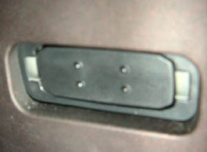

    Is the slot all the way sprung out? If not this may trick the Prius into thinking the key is still there.
