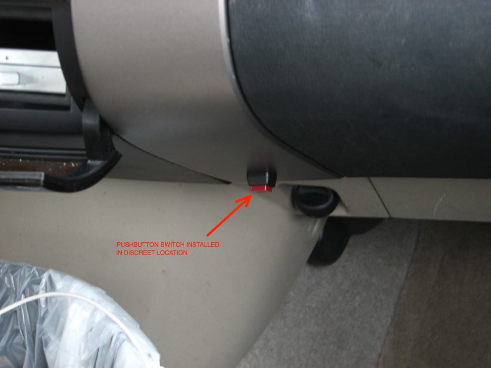

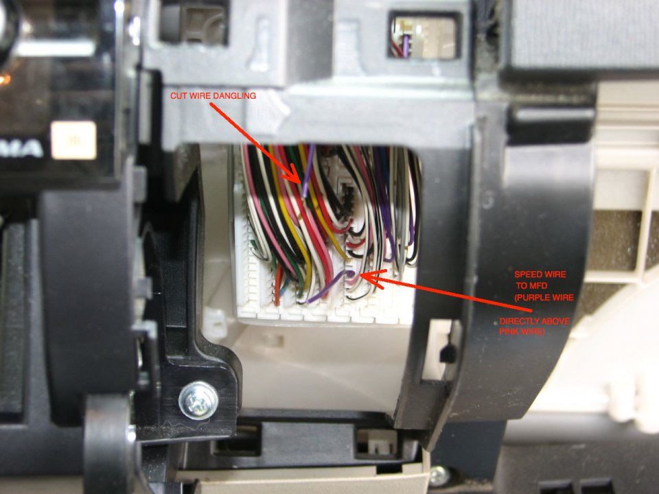

    I made good use of the advice in this chat thread for my 2007 Prius, without a navigation system but with the MFD and JBL audio system. I had already installed a VAIS MultiMediaLinQ (MML) unit, which was working well to display my iPod Playlists and Songs on the MFD, at least while stationary.
    As Darell's site (linked to from the reply above) said, don't even think about cutting the speed wire to the MFD (multi-function display) to get access to audio controls while you are driving. This is very, very dangerous to do. I much prefer fumbling in the dark for my iPod, which I can't really see in the car because of my middle-aged farsightedness. I prefer to stare helplessly at its little screen while holding it at arms length in my right hand, wishing I could see the teeny, tiny song names, while praying that I can find the song I want before I crash into the car in front of me. It would not make any sense at all to instead display the Playlist and Song on the heads-up display using a the nice new VAIS MML unit, which displays the information in large, bright text just below the windshield so that I would still be watching the traffic.
    So no, I would never, ever recommend cutting the purple wire shown below, and installing a nice little push-on/push-off button for enabling/disabling the connection between the speed wire and the MFD. Incidentally, also don't consider using the Coastal Tech Lockpick 3 because it seems incredibly overpriced, and would also endanger your life, but for $250 instead of endangering it for free!
