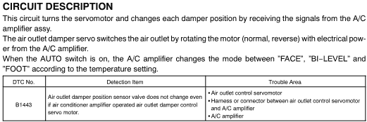

    B1443 is the code for the air outlet servomotor not seeming to move when the A/C amplifier wants it to, so that fits the picture.
    On a gen 2, this servomotor is on the driver's side of the HVAC unit, the opposite side from where the blower is. (At least, that is true in the US. Is driving in Ro also on the right side of the road?)
    So it seems unlikely to me that replacement of the blower should have disturbed this servomotor on the far side of the HVAC unit. But perhaps it is worthwhile to think back on what was done, any other electrical connections disturbed, for example.
    I have not inspected a gen 2 HVAC unit up close. It may be possible that even though the servomotor is on one side of the case, there could be some of the moving linkage for the outlet vanes on the other side, near the blower, and the blower replacement could have knocked something out of position there. Or some object could have entered the HVAC case and be obstructing the vanes inside.
    The B1443 code indicates that the A/C amplifier drives the servomotor to move, but does not see the position sensor reading change to show it has moved. While this can mean an electrical problem or a problem in the servomotor itself, it can also mean the mechanical movement is jammed or obstructed by something.
