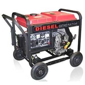

    You know you can get a 5-7kW high efficiency diesel generator and use it as emergency charger? Put it in the back and get pipe through the window, and drive while charging. :)
    From what I understand you can use heating oil in it and forgo road tax added to diesel at the pump. It wouldn't be illegal since generator isn't part of the car.
    http://www.amazon.com/DG4LE-Powered-Portable-Generator-Electric/dp/B002VWL23Y
