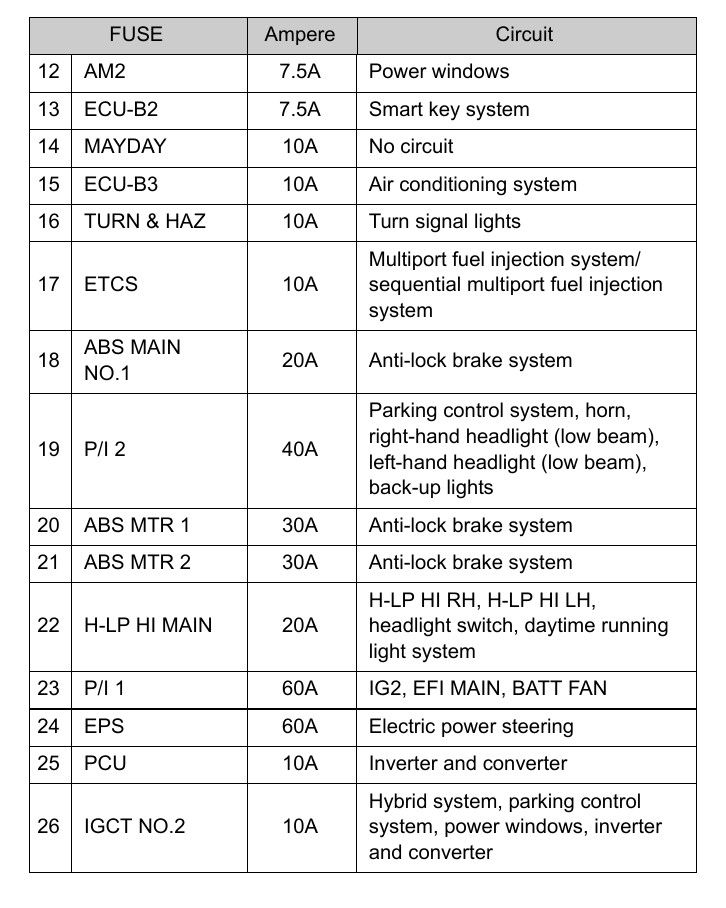

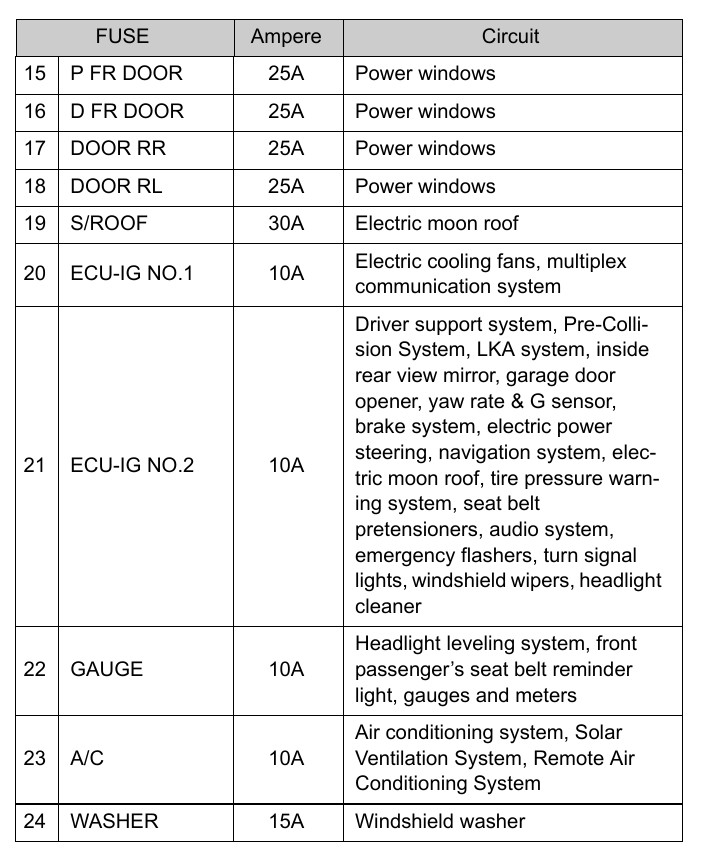

    Here's the fuse diagrams I did find though
    fragment-60ff3009abf9ed0004c50a76-8403ebd598.jpg fragment-60ff3009abf9ed0004c50a76-5a387e4d55.jpg fragment-60ff3009abf9ed0004c50a76-0e24eb770d.jpg fragment-60ff3009abf9ed0004c50a76-02ec304dc9.jpg fragment-60ff3009abf9ed0004c50a76-886d12f2f0.jpg fragment-60ff3009abf9ed0004c50a76-871dca17c5.jpg

    Thanks for the indepth direction! To use that diagram, is there a photo or exploded diagram I can cross reference it to? I'm still learning how to read the writing flow charts like these. :oops:

    This is the diagram of the piece of equipment that you took the error snapshot of.

    Oh, this one? I apologize I'm a bit confused and overwhelmed.

    This is a diagram for finding the part number of brake system parts. On a number of auto parts websites, when selecting a part number, the backlight is highlighted in different colors for a clear presentation. This provides a little help to visually check the required number and not to mix it up when ordering.

    Is that the one that will have the wiring I need to check for rest and corrosion? That one looks like it's in the engine bay?

    Yes, it's in the engine compartment.
