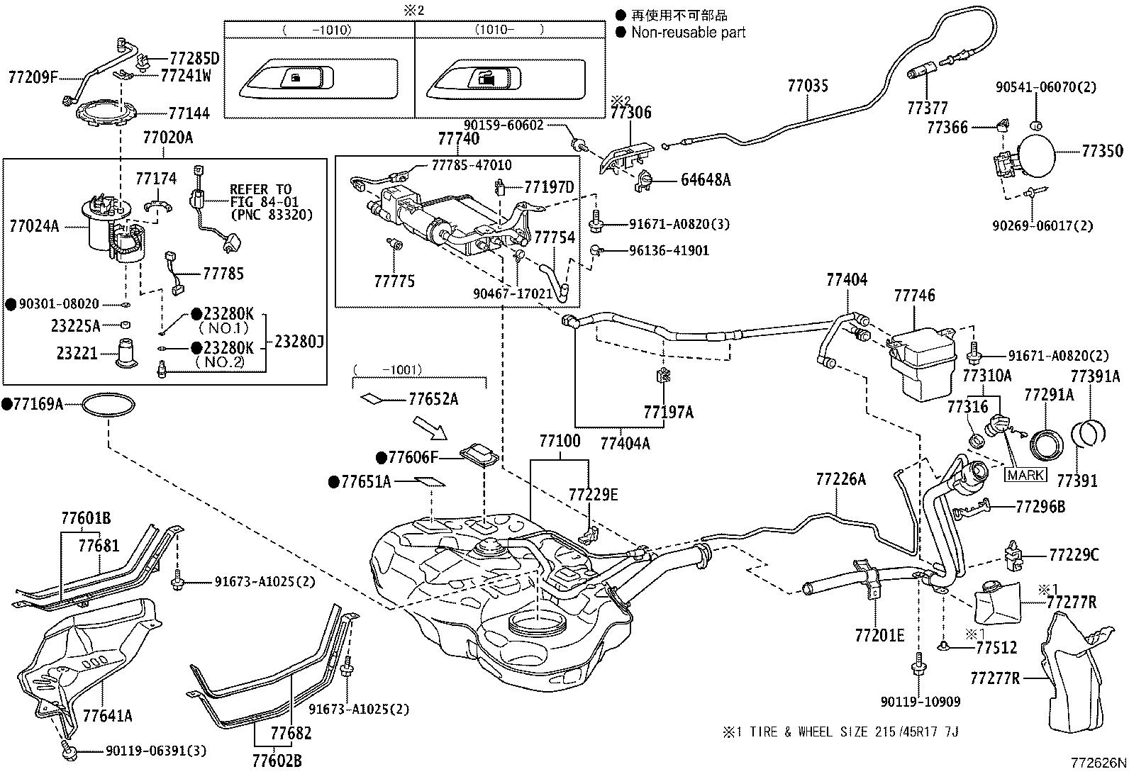

    Low fuel pressure can cause a lean mixture and misfiring. It could be the issue if you have a P0171 code reported, or large values shown for the long-term fuel trim. Then you can check the pressure with a gauge. If that shows the pressure being low, the pressure regulator might be the culprit.
    It's 23280J in this drawing, but I'm not sure how many people take things apart to that level, versus just replacing the 77020A fuel pump assembly.

    If your model has only one hose connection to the tank, I would struggle to see how the regulator could be anywhere else but in the tank.
    But finding the diagram for your market region would be the best way to see. I do not know where USSA is.

    No, that hose from the intake is the vapor system purge hose, and if you trace it back, you'll end up at the charcoal canister, as shown in the diagram above and also this one:
    Dropping the entire tank is one way to find that out, but looking at the diagrams is another; it's like what Westheimer said about how a coupla months in the laboratory can save you a coupla hours in the library.
    The vapor purge hose doesn't carry liquid fuel, and isn't involved in the pressure regulation.

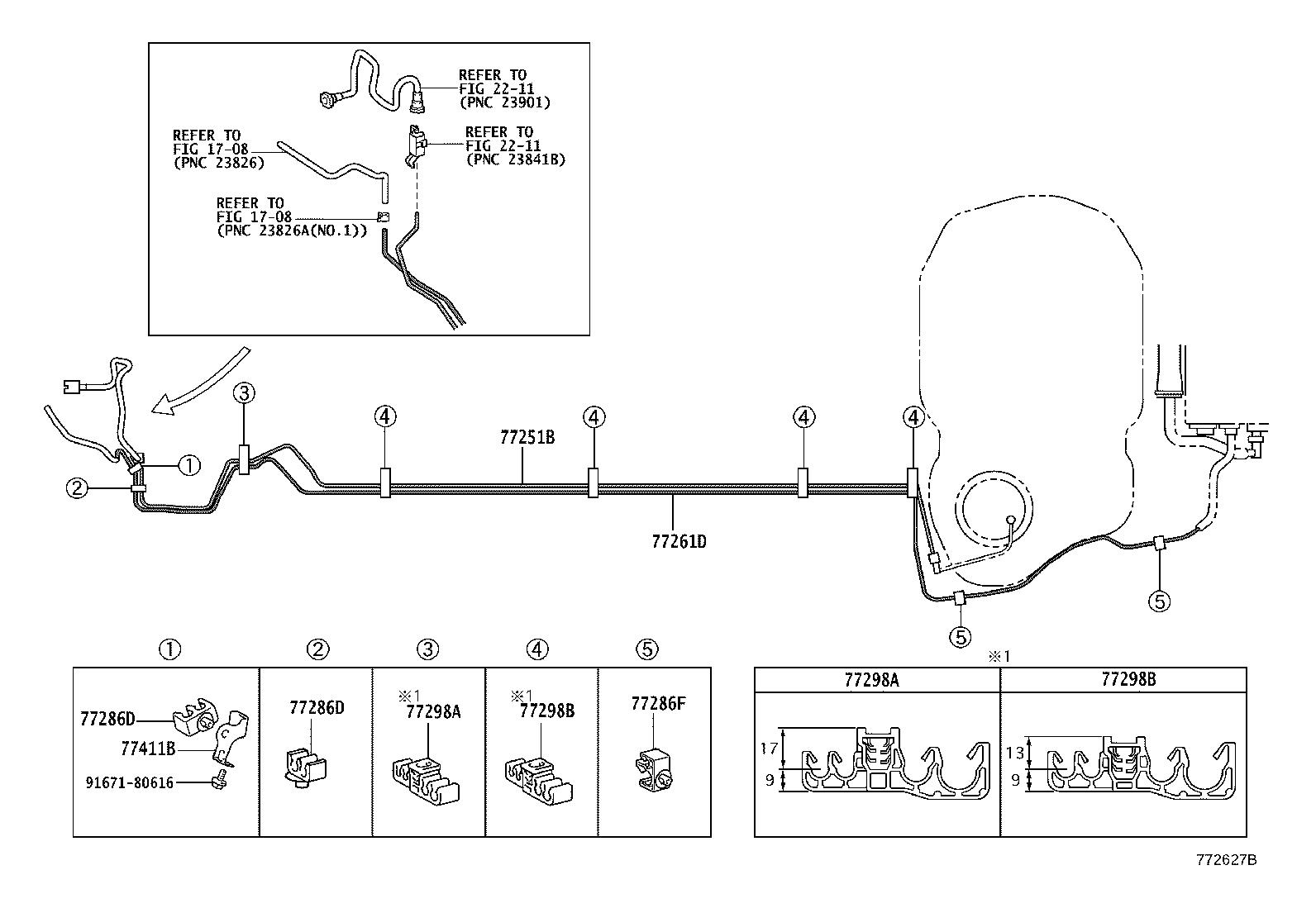

    If you are in the USA, your Prius should match the diagrams I am taking from parts.toyota.com, which are for USA models. As you see from the diagram here, there is only one tube forward from the fuel tank, which does match what you have, no?
