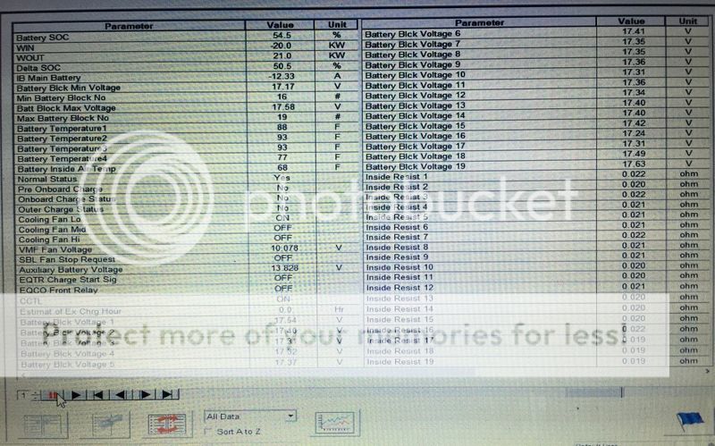

    You did it, but you didn't do it aggressively or long enough. The peak charge was about 12A, and you never got higher than about 55% SoC. You need to mash both pedals... floored in "D" right up until it won't charge anymore.
    Here's an example of a Gen2 charge from 61 to 83.5% SoC (42.4A average current, 770mAh input):
    SoC is blue line, charge current is magenta, and their values are on the right Y axis. The rest of the lines are the 14 blocks, and their values are on the left Y axis.
    Note that this was a relatively healthy pack, it just suffered from severely reduced capacity due to voltage depression. The jumpiness of the data near the peak suggests there was no significantly "worst" module. The Min/Max block numbers were jumping all over the place, which is generally a sign that they are performing in sync with each other with no outliers.
    Where the voltages peak at a current of 45.7A, the min-max delta was only 0.24V. The max delta V of any data point in the test was 0.31V - those are pretty good numbers.
    When you have an issue, you'll see the same 1-3 block numbers coming up as a min or max depending on the test. On my Gen1 rebuild with Gen2 modules, during the discharge, near the end of the tests, blocks 1 and 19 came up exclusively as they were the lowest capacity blocks. Max voltages during the discharge test were most frequently 10 and 11 as I put the highest capacity modules in the middle.
    The numbers mean the most with the current flow is highest and you are closest to the min or max SoC thresholds.

    Ok, this is the final version. Some technical details about the conversion:
    • Used text editor to replace all ";" with null "".
    • Loaded into excel as delimited text, just <TAB> character
    • Copied "TesterSnaps<n>" to a second sheet
    • Removed the "MM/DD/YYYY" from date and time to get start time for each series
    • Added start time to each sample row
    • Replaced long text with shortened version for first header
    • Copied transposed abreviated and original text to right most columns
    • Removed redundant header text rows and sorted data
    • Plotted traction pack amps, highest and lowest voltage modules
    • Adjusted scales and data series to make it easier to read
    About the data:
    • Lowest was always #16 pair but others are close
    • Highest switched between the end pairs #1, #19
    • Voltage offset > 0.30, enough to trigger the fault
    • Battery internal temperatures were warm enough, 30-35 C, the fan was coming on low
    • Insufficient data to call the capacity of modules

    During Draco's load test Techstream reported the minimum voltage as 13.98. Seventeen of the 19 blocks read BELOW this voltage. There is a sampling delay in reporting the min and max voltages. I see this all the time. It could screw up data collection.
