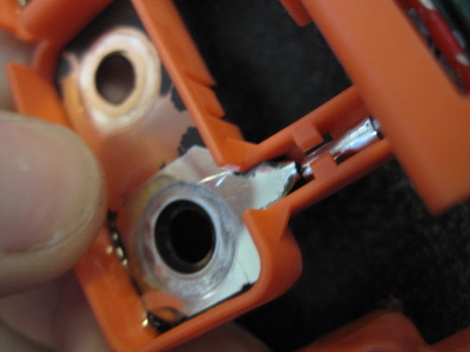

    P3030 = HIgh Voltage Line disconnected/snapped???
    WTD? who installed your battery?
    Did you or they install a new Bus Bar with sensors? If old one was put back on, one or more of the sensors could be corroded and throwing this code.
    Pic of a micro fractured sensor tab on a old bus bar
    Again a TIS report will show which sensor is FAULTY. This is almost a definite source of our P3006 code
    #15 DRACO, Jan 13, 2016
  16. kmc6566
    kmc6566 Junior Member
    Dec 2, 2008
    61
    England, AR
    I replaced the entire battery with a Dorman battery. Aren't the bus bars inside the battery?
  17. DRACO
    DRACO Member
    Nov 28, 2015
    362
    78
    Rancho Palos Verdes, California
    2002 Prius
    Under the cover, YES.
    That means the replacement battery's bus bar may be defective but your TIS report will confirm it.
