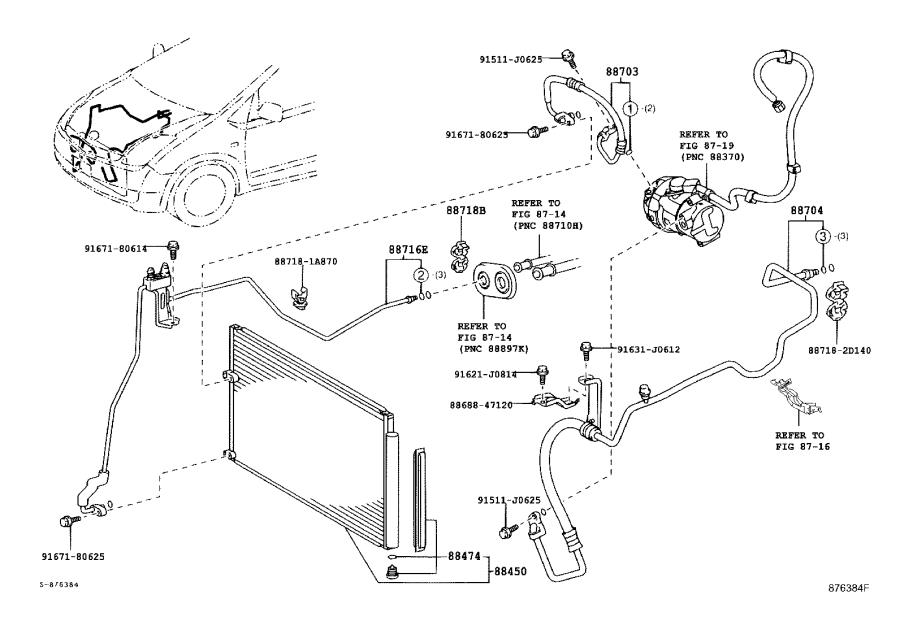

    What’s up everyone! Long time viewer, 1st time posting. I have a 2004 Prius. She leaks refrigerant out by the sight glass. Is the Oring on the switch something we can get separate or do we have to purchase a new switch? Also was wondering if the system needs to be evacuated prior to removal? Any halo would greatly be appreciated

    I'm not certain you can even do that. From Toyota, anyway, it looks like you'd just buy the entire liquid line, 88716E, which has the sight glass and pressure switch in it.
    And yes, after replacement of that line, the system would definitely have to be evacuated and properly charged. The receiver drier, 88474, should be replaced at the same time.

    Pressure switch I see is welded on in the making of that high line. You can see the world I don't know why it has flats on it maybe they're welding in the aluminum ones that used to have the threads on them have no idea but you won't screw this one out and when you do you'll be twisting the aluminum and ruining it and need the whole high side line with the switch like Chapman said earlier I went out and looked at my Gen too there is no way that that part is coming off that whole block is permanent
