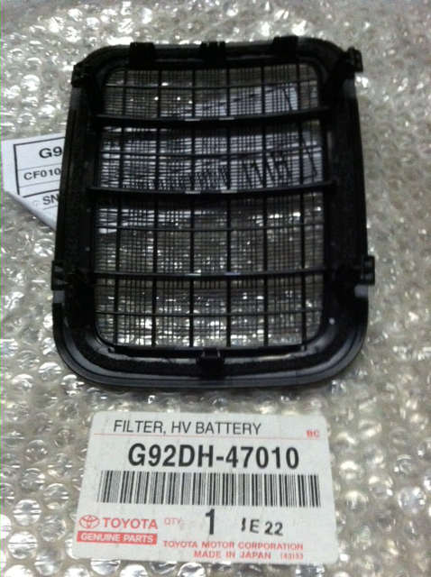

    The filter snaps over the outside of the stock vent grill. Refer to the last photo in post number 19.
    This part has been released for the Gen III Prius to mitigate excessive dust build up in the HV-Battery cooling fan, where the vehicle experiences very frequent ingress/egress from the back seat while the vehicle is running, such as a taxi.

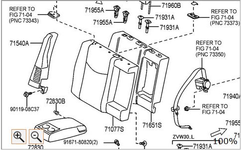

    I found a picture for the seat cushion/grill. The seat cushion that Mendel referred to is 71540A (full part# is 71540-470xx where xx is for various color/cloth/leather) and the bolt is 90119-08C37.

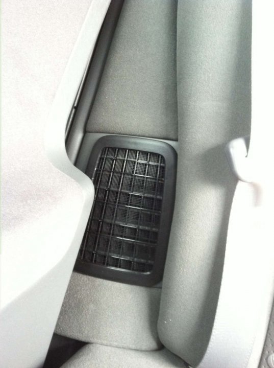

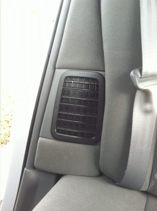

    Below is my actual install. Other than it isn't gray to match my interior color, it doesn't look bad at all...:)
    BTW, I went back to MidAtlantic website... In addition to G92DH-47010, they also have G92DH-47020, G92DH-47030, etc. I'm wondering whether the last 2 digits are for different colors? If you haven't bought yours, you might want to check it first.

    Darn, I should have read this before ordering the G92DH-47010. It's black, eyesore, and little filtration if any. More like protection "against foreign particles," as the crudely translated instruction states. The
    G92DH-47020 is only $6 and G92DH-47030 is only $3. I could have ordered both for the price of G92DH-47010. But maybe they are not filters?

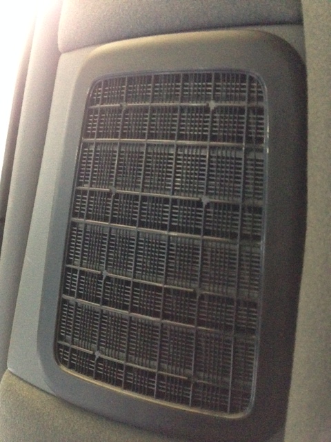

    Here's my filter 1 year after installation. The filter doesn't accumulate much dust at all. I seldomly carry passengers in the backseat. I don't smoke and have no pets. Maybe that's why the filter looks pretty clean :cool:
