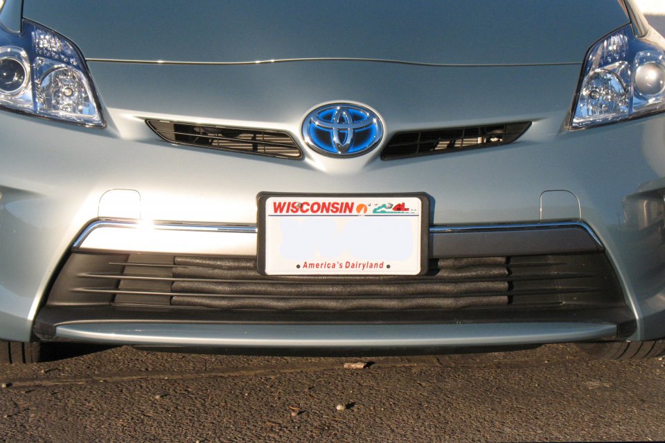

    Does not look the best, but in 8 years have never lost a strip of foam yet.

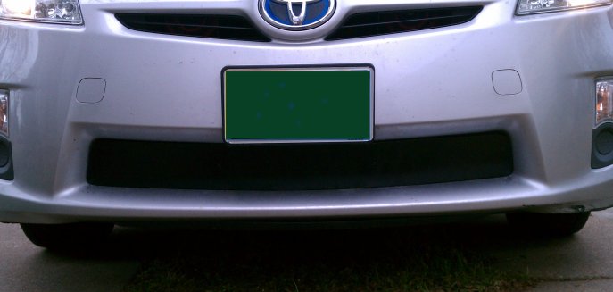

    The only details that dont show are two zip ties that hold it on. Otherwise it is a piece of plywood painted with black enamel spray paint I had laying around. Several thick coats front back and sides to keep the moisture out.
    It is a perfect fit but is not sealed with foam or anything and it really doesnt matter. It blocks probably 90%. It didnt cost anything and I dont have to mess with the foam.

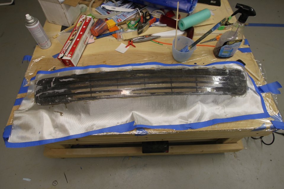

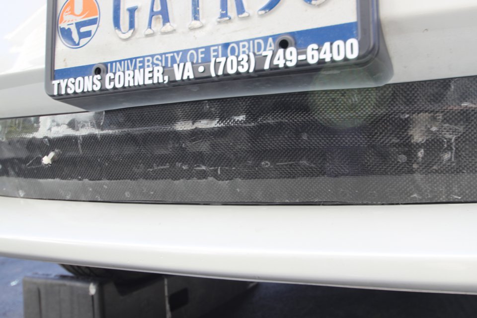

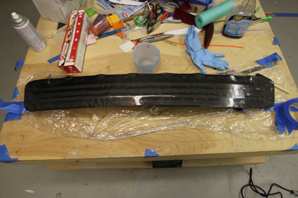

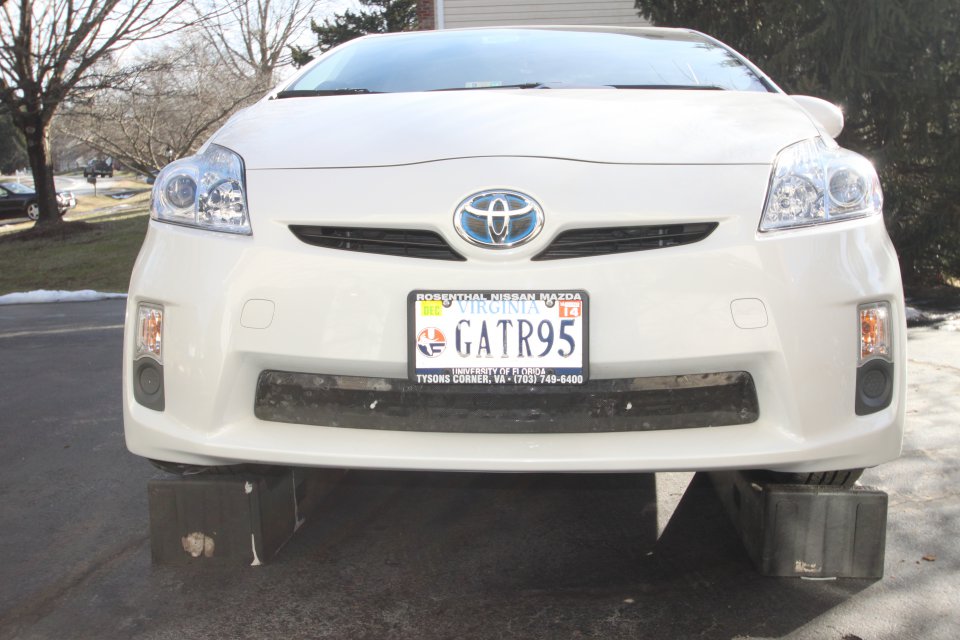

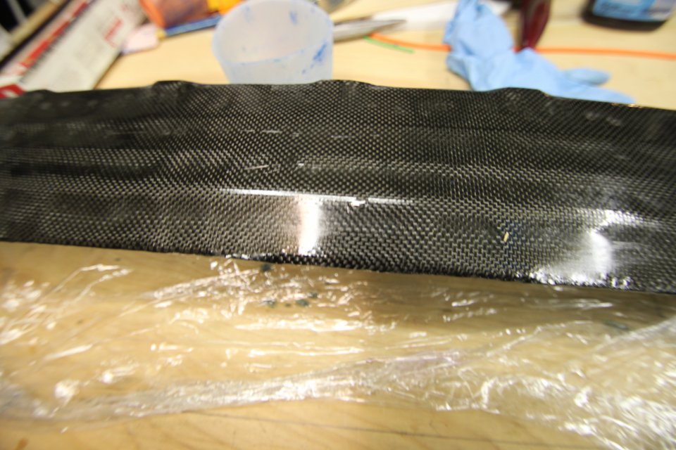

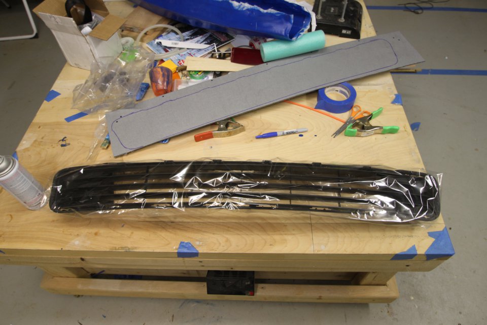

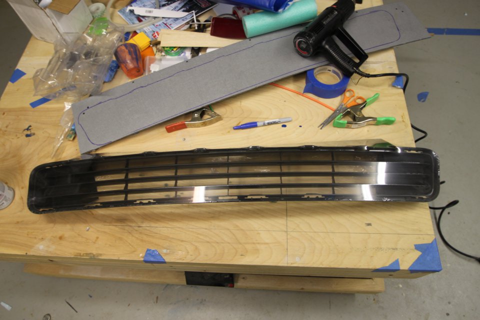

    I made up a grille block out of fiberglass and carbon fiber. I took the lower grill out so I could get a form fit...not realy happy with the visible finish, I figure some sanding and epoxy work over the summer will result in a better finish.
    I had though about using Zeus style fasteners but ended up with the white zipties for the short term
    James Analytic likes this.

    Take the very front underpanel piece off and you should be able to fish it out. 1.5" OD foam tubes are easy to work with. Two rows block the lower grill 100%. I just leave them at their 4' length, push their slits onto the grill slats, secure with velcro strips (one toward each end) that wrap around the slat and tube with an inch or two lap.
