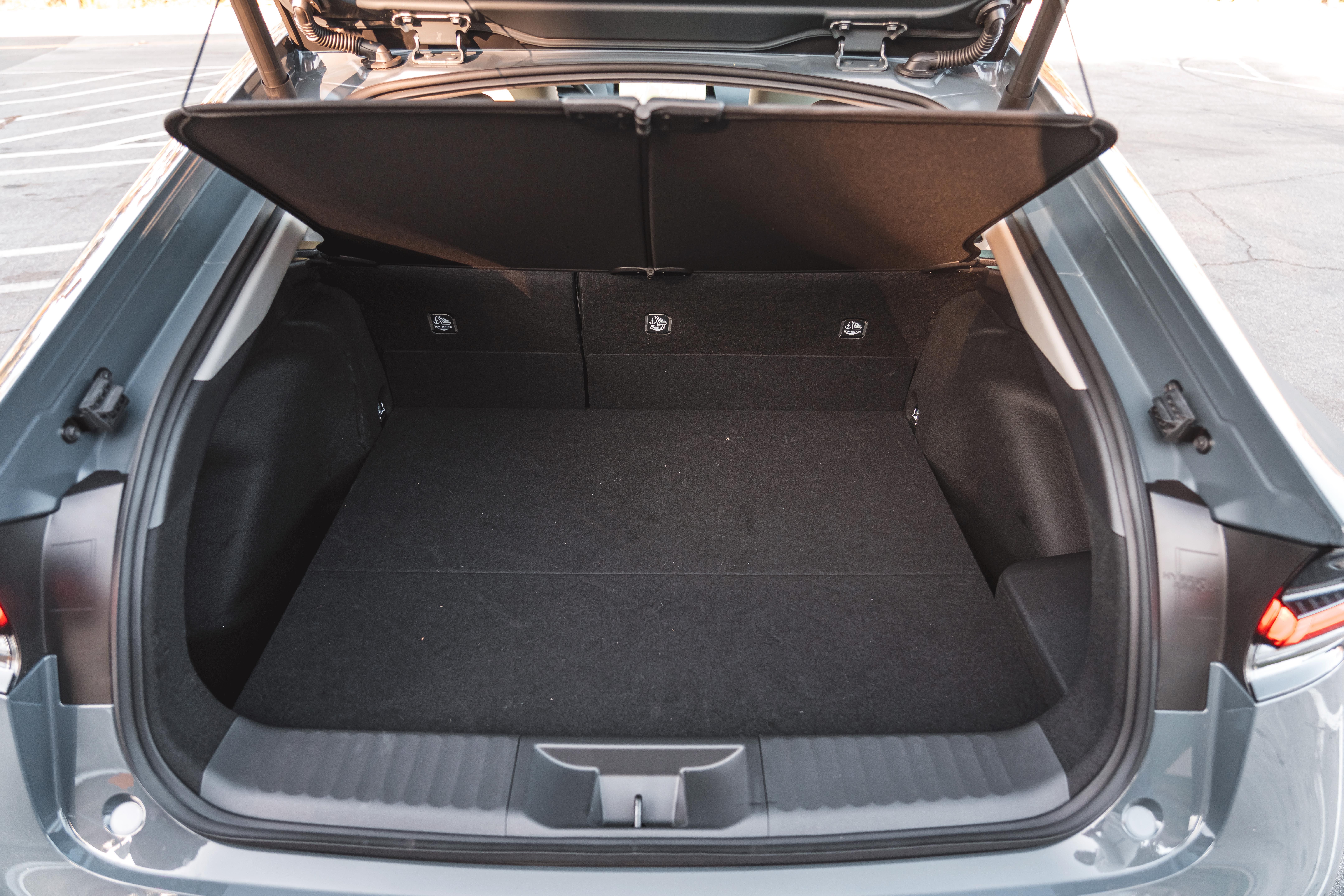

    Here is the cargo area in higher trims.

  8. bisco
    113,892
    51,844
    yeah, something doesn't add up. there's no way you can have a spare and more cargo space, unless the hatch door is higher, or the seats are further forward

  14. Trollbait
    23,429
    12,505
    I think SKS info came out of the owner's manual.
    That floor in the back has a 'thrown in' vibe to me the way the side edges just drop off instead of becoming part of the side walls. After checking out that space in the above video, I'm thinking it is an add on for the higher trims. You get the floor with extra storage cubbies to level the cargo floor with the folded seats. The LE just has that space open.
    Well, just looked at the manual, and it ain't looking good about the spare. There is a section on storage features in the interior features chapter, with illustrations. The part on cargo hooks(p.375) has instructions for cars with tire repair kit type A and those cars with repair kit type B or spare. The B/spare have a deck board, the raised floor in the photos; it has to be lifted to access the hooks. The type A cars don't have that deck, and thus more open volume in the back.
    The 2023 Prius LE does not have a spare tire in the US. It might be available as an option that removes cargo space.

  15. Gokhan
    Gokhan Senior Member
    Oct 5, 2008
    6,152
    2,432
    Paramount CA
    There are three options:
    Option A: comes with Type A tire-repair kit and has more cargo space (lowered deck)
    Option B1: comes with Type B tire-repair kit and has less cargo space (raised deck)
    Option B2: comes with spare tire and has less cargo space (raised deck)
    Note that for Options B1 and B2, the deck height is identical with tire-repair kit or spare tire.
    It is not clear which trim has which option, and the specs provided by Toyota seem to be in error.
    Trollbait likes this.
  16. Trollbait
    23,429
    12,505
    As I stated the other thread, the cars the reviewers are getting have the higher trim wheels with Option B1.
    Plus, the only way the LE can have a larger cargo volume on the Toyota site is with Option A.
    It is looking like the spare isn't going to be standard in the US. Hopefully, for those that want it, it will be an option instead of having to cobble together a solution after sale.
    For those in Canada, the raised deck and whatever underneath appears to be simply bolted into the Opt A set up. Swapping the storage cubicles for a spare could be simple.
