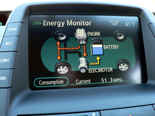

    What screen do you look at to determine the amount of battery charge?

    there is an icon of a battery with bars that show the level of charge. it is in the power flow screen.

    Hi trader. Look at the following screen on the LED "multifunction" display. The battery icon shows 6 blue bars in this case. It can show anywhere from 0 bars up to a maximum of eight depending on the state of charge. Six, as shown, is the "nominal" level that it prefers to be at.

    Thanks! Found that screeen. Looks like everything is good on my newly aquired '07 Prius!
