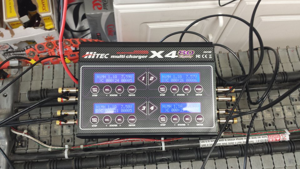

    Up and running with new leads. Results to follow. I bought 14 guage bulk wire. They didnt have the GE banana plugs so I bought what they had at 5 bucks a pair.

    Well, so far its not looking good. 3 out of 4 so far have peaked out in the mid 3000's on the first charge cycle. I guess ill let it finish the cycles and hope for the best

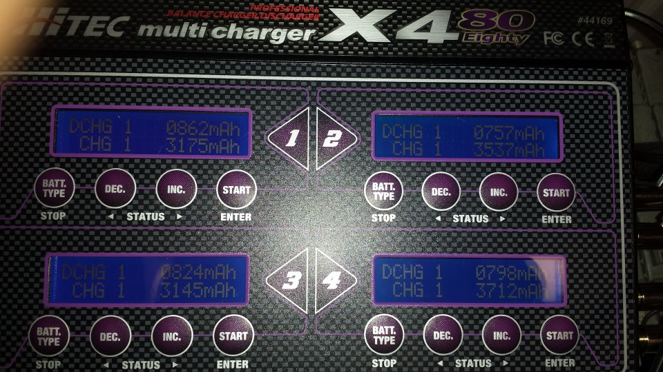

    Ok im gonna try 1 run on manual mode. But what I meant was, my numbers came up in the 3000's, they just completed the last charge cycle. So I write this down and run subsequent charge cycle till I hit 7000mah. Maybe auto mode is what is doing it though so ill report back. Heres the second set of 4. Just ugly.

    Hey, at least they're coming up. If you can input 7000mah into them, these modules will be fine. I'm not familiar with the HiTec X4 so I don't know why its auto shutting off at less than 4000mah but you have to put in 7000mah to even come close to getting 6000mah out.

    Im not sure either. Maybe a defective charger? Who knows. Im running a subsequent charge now, so far they've all taken an additional 1000mah so we'll see where they peak out again. Ill just watch it and shut her down when I get to the magic number. Thanks for the input. Dont know where I'd be without this forum. Probably shelling out $1800 bucks! Haha

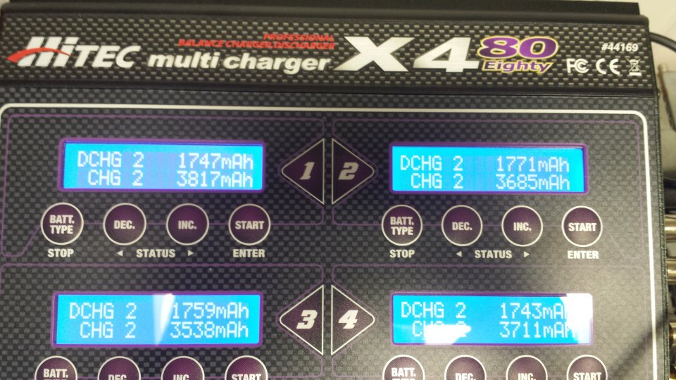

    Good info to know, I suspect this is why most grid chargers aim for around 350 mA (0.35A). Doing a manual program on a Hitec X4 like I did will definitely stop on capacity input but then again my modules came back to nearly full capacity in all cases. Even the replacement module was from a 2006 Highlander Hybrid and it came back to around 6000 mAh too.
    Yes, the auto mode is definitely limiting how much capacity is being put into the modules on the charge cycle so I'll be curious to see if the manual cycle did any better after. The critical part is not what you put in, it's what amount of capacity is being returned on the discharge cycle (ie looks like you are getting just slightly less than 50% of your input capacity back on each discharge). If the amount being returned starts to go up (ie you put in 5000 mAh and you now get 3500 back, that's a good sign) then your modules are improving and you want to continue until you don't see any more increase in capacity returned.

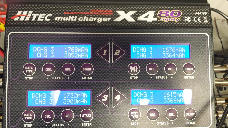

    Sounds good. The charger peaked out the second time around at 1200 to 1700mah. So I did my calculations and went for round 3. It peaked out at 600 to 800mah. Getting closer to 7000mah now. Hopefully once I run them up to 7000 and discharge, they wont peak out so low then I can run 2 more cycles without having to go calculate and start more charge cycles. Anyhow, yeah im hoping they come up and ill keep cycling till I see no further result. This is gonna take longer than I thought but oh well, bought it as a project car and dont need it for driving so... thanks for all your help! Ill keep you all updated.
