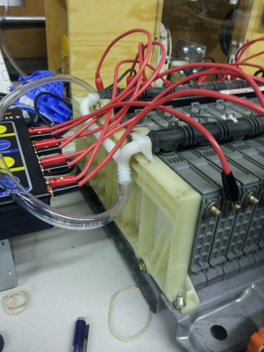

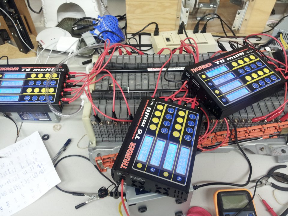

    I have had my Prius down for a couple weeks now and am starting to cycle the pack. Here is setup. I got the chargers from lamtech.

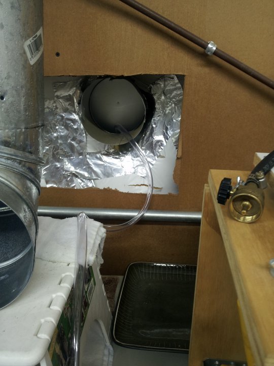

    I noticed that no one has talked about outgassing from the modules. Since starting the cycles, I notice a distinct smell. I attributed it to the chargers, but seem like the smell kept getting stronger. I concluded that it must be the batteries themselves and went to buy a 6' vinyl hose and connected it to the pack. It solved my odor problem. I have some pics below exhausting outside.

    That's because we try not to overcharge the modules too much (and keep the charging rate below 1C).

    I would get gas even with 1A and 7250 mAh limits. I still needed the hose to remove the outgassing. Maybe my nose too sensitive. I also try to keep the modules below 80F during the charge, but I have seen it go as high as 89F
    The setup allows me to charge 12 modules at one time so that maybe cumulatively the gas is coming from up to 12 modules.
