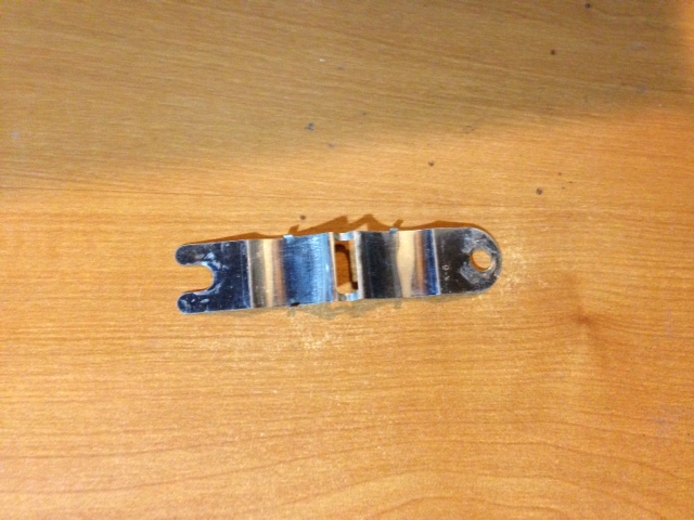

    I
    I got one of them running by replacing 2 bad modules. I am getting a P3030 code. I think I might have damaged one of the sensors when I took everything apart and put it all back together. Especially since I took the bus bars out and cleaned them up. Also do you know where this goes? prius-part.JPG
