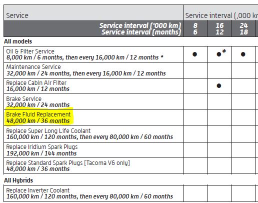

  16. Mendel Leisk
    60,023
    41,255
    This is an excerpt from the Canadian 2014 Owners Manual Supplement. It's a bit different than the US maintenance book, in that it encompasses EVERY car Toyota sells. At least they're presenting a nice chart now. Anyway, they're coming around: there's a brake fluid change interval now:
    When we had ours in for the Brake Master Cylinder recall, I asked if they would be changing the brake fluid, and if not, could they do it anyways, even if it amounted to an extra charge. They said they did, and it was gratis. I'm not 100% sure I'm buying it, suspect they might have just replaced what spilled, didn't go around the four bleed bolt locations. Will for sure get it done (again?) at the 6 year mark.
    BeatleBob likes this.
