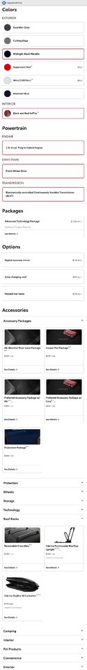

    I still see it on the 2024 Prius Prime configurator. Here is the link. I don't see it on the 2025 configurator but just the 2024 configurator. Here is a screenshot.

    That's odd. It only shows up on the 2024 Prime as an option. It doesn't show up for the 2025 Plug In or the 2024/2025 regular Prius. Hopefully they make good and do come out with a roof rack that doesn't require modifications.

    My guess is the inclusion of the roof rack in the customization for 2024 is a mistake, I can't find anywhere where Toyota is selling a roof rack they claim to be compatible with any Gen5 Prius, and the photo there is of the Gen4 roof rack that otatrant bought and had to modify to fit his Gen5. Not to mention it's only for the 2024 Prime, and only on the US site, where the option appears

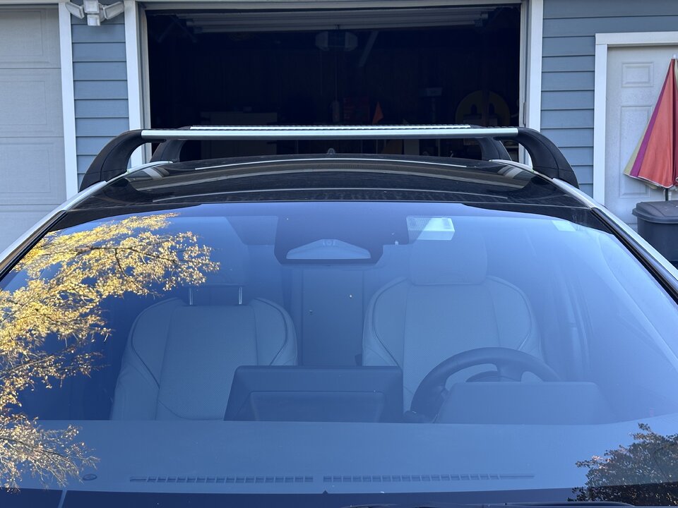

    Not much if any news. I installed them then installed the Thule Caprock onto them. One minor issue I had with the installations was I lost a bolt from the Caprock while driving at slow speeds which I replaced. Probably due to missing it when going around and torquing the bolts. Luckily there is redundancy in the support for Thule Caprock so losing one bolt was not catastrophic.
    I haven't removed the Toyota crossbars since installing and don't plan too either.
    One minor issue I noticed early on was a tear in the driver's door weather seal. I doesn't need to be replaced and I am pretty sure it is only the drivers door. Part of adjusting and installing the rack is adjusting how much space is between the roof and the rack supports. The driver's door has a little more space in between and is the door I use most so attribute the tear to those two factors. The tear is pretty tiny probably like a millimeter or two.
    I try to check the racks regularly and it always has felt really solid.
    I only drove a short time with just the Toyota racks on before installing the Thule Caprock. Some people with 4th generation Prii complained of wind noise. I bought a wind diffuser early on but returned it since the Thule Caprock comes with one.
    If you are someone that is very conscious of mpg you may notice a couple mile per gallon decrease.
    Can't think of anything else. Pretty happy with how it has turned out.

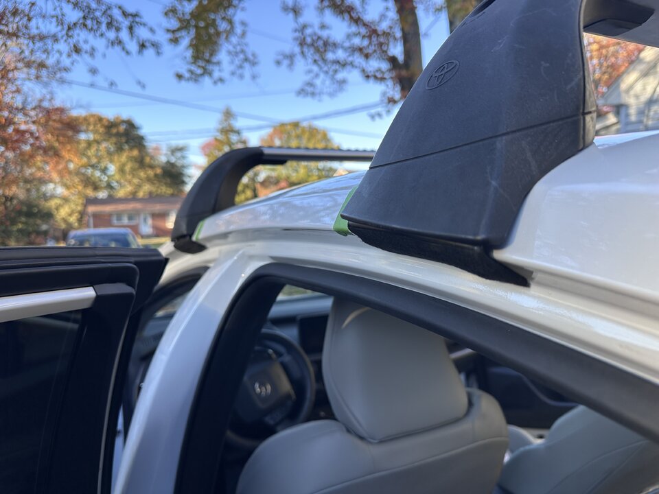

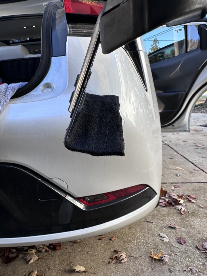

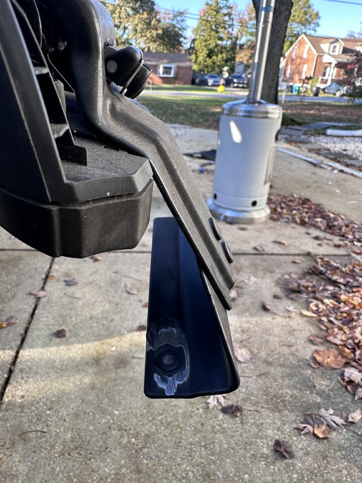

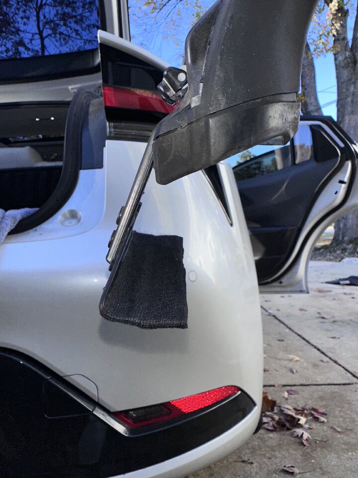

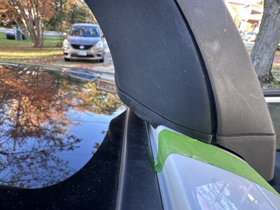

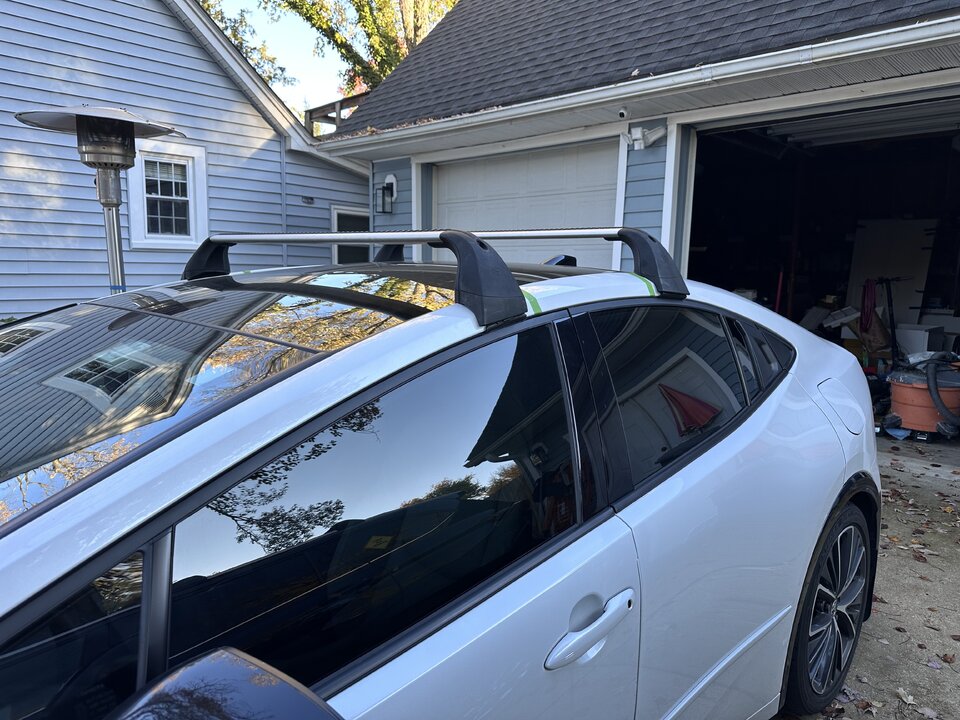

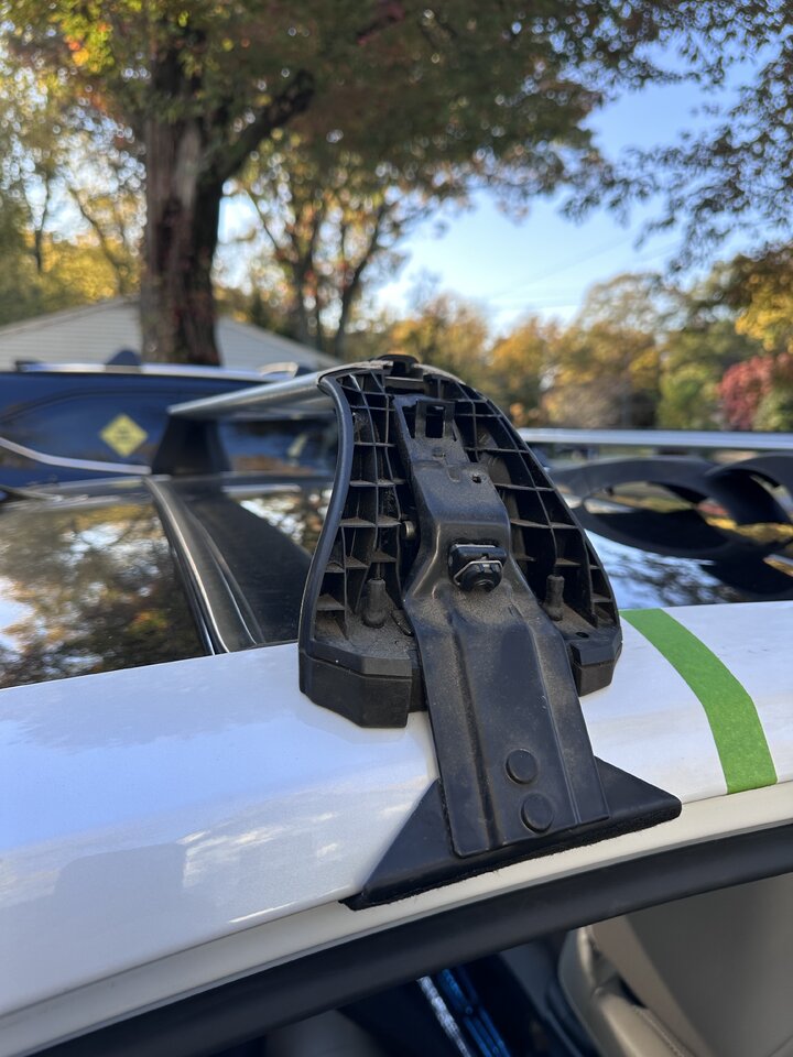

    Well … I did a thing.
    found OEM cross bars on marketplace for $100. My objective was to 1) NOT cut the rubber and keep the lip, it was most important to me, 2) give at least 24.5 inches space in between. Achieved both.
    First thing - cut off metal pins. I then grinded them down to make sure car does not get scratched. Then put gofer tape and wrapped around in electric fuzzy tape. This was whatever rubs while tightening down does not leave mark.
    Unbolt all four brackets to its maximum capacity.
    At this point the rear should install right on, no further modifications.
    For the front , I kept unscrewing the bracket bolt until it came out. Yes it will come out with much force. I kept applying WD-40 on the bolt (the end inside the bracket) and twisting. Once out I made sure the thread was good by checking the bolt and the nut. I used another similar bolt to make sure thread was good, and used a nut on the bolt which I removed. Then Mount the cross bar in the desired location (started with 24,5 inch space) and bolted on the bracket. Perfect! I then realized it can be pushed forward a bit more, achieving 25 inch space.
    I positioned both front and rear where the lip was right on the edge of the roof. See pictures.
    That’s it. Tighten brackets. I used another tool, not the one which comes with cross bars. I kept tightening until it felt secure while checking the lip.
    Happy to answer any questions.
    ps. I will undo all and add thin rubber strips under brackets. Don’t want to take any chances
